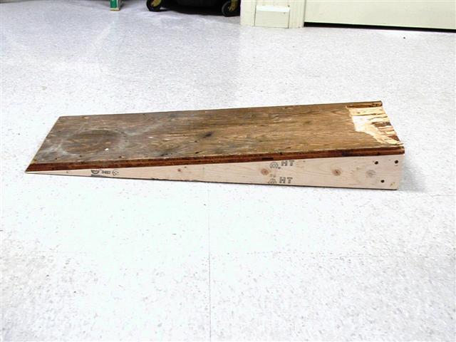

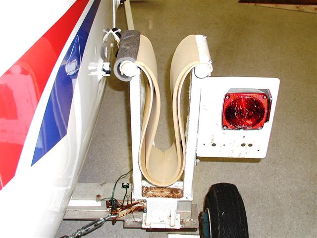

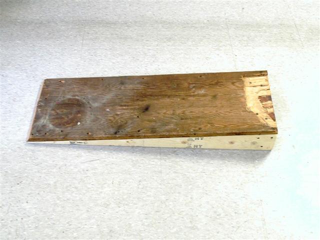

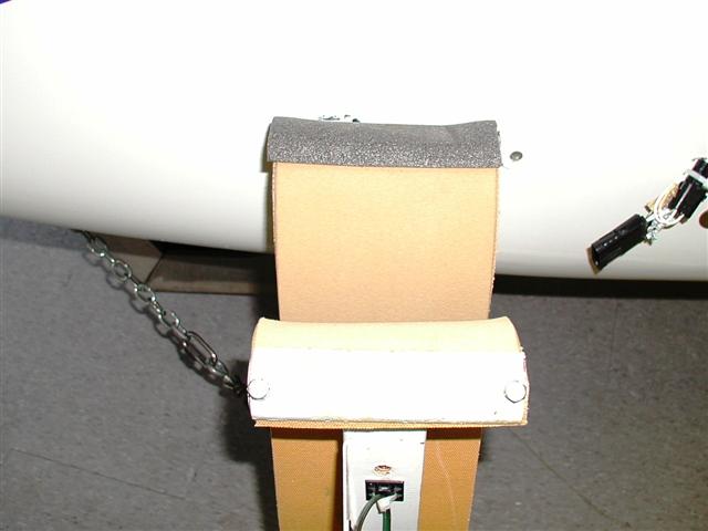

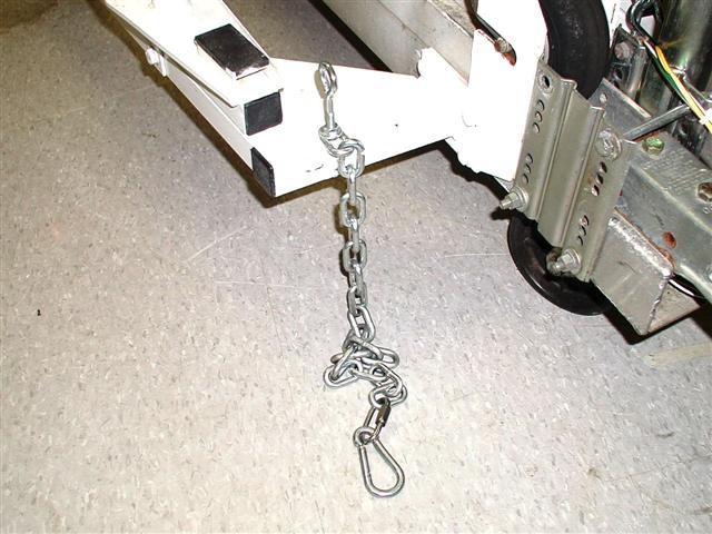

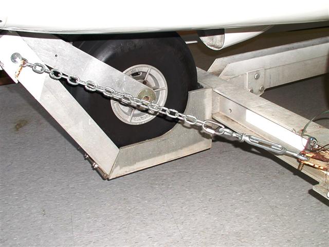

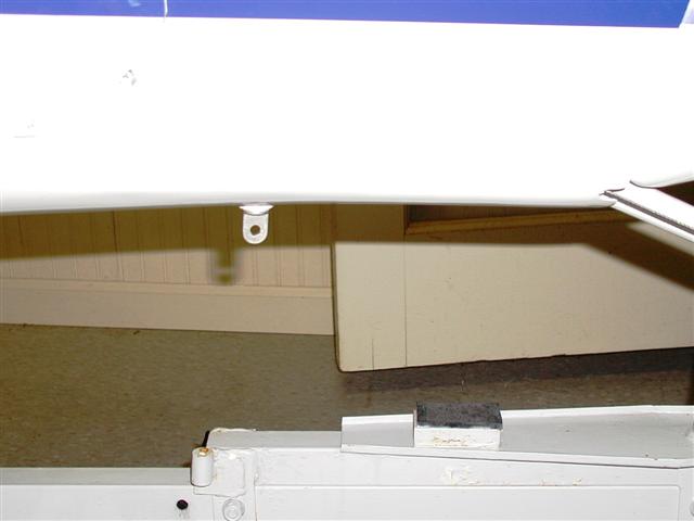

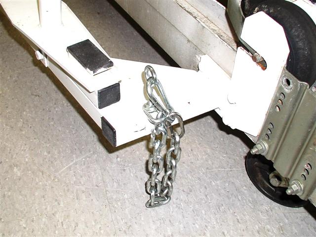

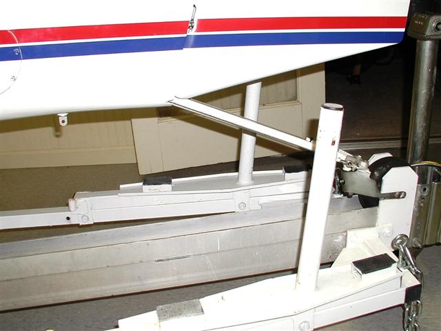

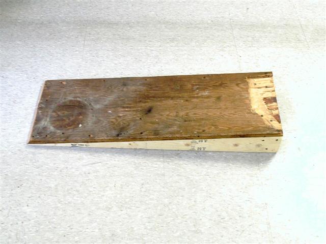

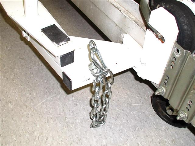

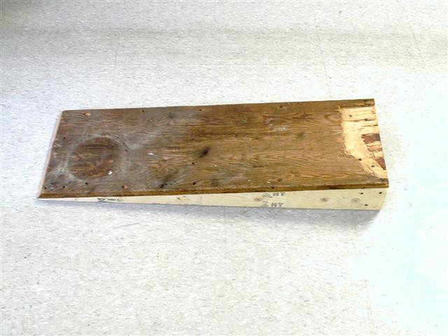

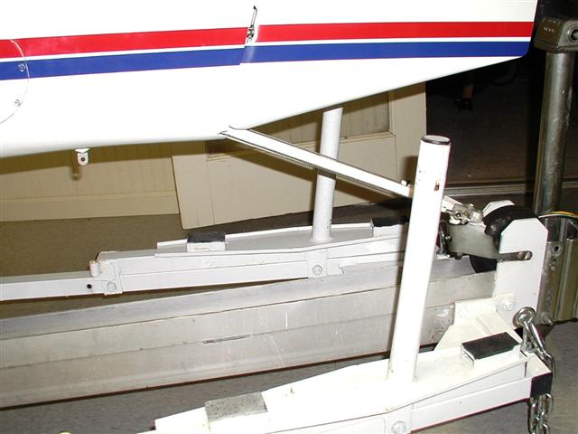

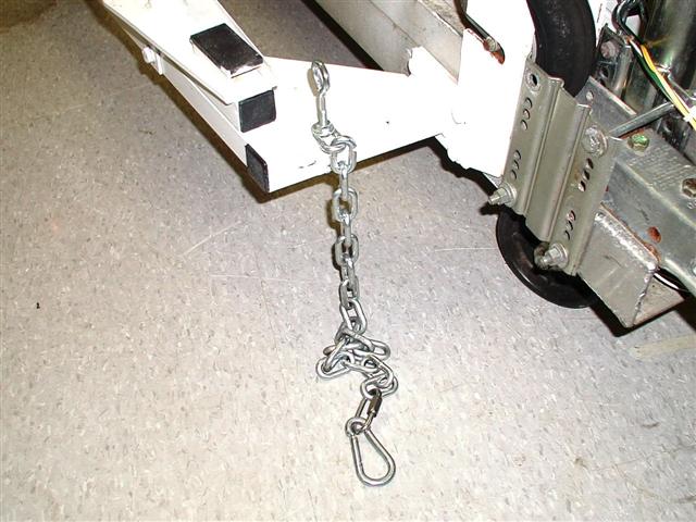

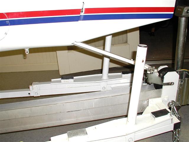

I am attaching a couple of pics showing the following:
Ramp I made to lessen the angle on the ramp so one person can easily push the A/C into the wheel cradle.
An eye bolt that I use to secure the tail to the trailer as well as a tie down point for the airframe. This prevents it from going forward, just in case.
Trailer safety chains.
The wing support straps that I made to hold the wing.

The wheel ramp attachment bar, where did it come from? Was it with the trailer or did you make it.
Did the mud guards come with the trailer or did you add them. As you can see I don't any.

dropping them to the trailer.
The spars are secured by clamps tightened
by bolts - not only by pip - pins like original
factory trailer. I do not wanna get any damages
to the spars´main pip pin holes.
I have also some other modifications like
douple axle for security reasons. Look at the pics.
The riskiest part to operate Europa in my case
has been so far when pushing it to the trailer:
- I have almost destroyed my rudder by hitting it
to the back door of my van´s (it was open)
- main wheel gate opened when towing the trailer
(I was lucky Europa did not dropped to the road
because it was fixed by bolts in the tail wheel
and it was not on it´s side because I have extra
side supporters). To prevent this situation meet
me again I connected those turnbuckles keeping
gate up together by a strong rubber string with
hooks which prevent them to open spontaneously.
- tail wheel dropped from the rail and transponder
/DME antenna went broken
- tail wheel dropped yesterday again from the rail
and Dynon´s OAT sensor went broken and penetrated
through Europas stomach (so I have a similar extra hole
in my Europa´s fuselage as Ferg Kyle has his wing´s
leading edge!)
Personally I think the only almost safe way to carry
Europa on the roads is to carry it in a big enough lorry
/truck with closed coach. No towing at all. Only flying...
Raimo

Hi Stevie
Now I have some questions.
They are self made. There is one extra advantage with them:
the ramp has quite a tight fit to the monogear and they are difficult
to separate. By using these attachment bars /giant turnbuckles
you can force the ramp move upp AND also down (by chain only upp).
Look at the attachment.
The mud guards come with the trailer with one axle. The other safety axle
and it´s mud guards have added here later.
Because of my accidents "tail wheel drops down when pushing the plane
to the trailer" I will instal this week a floor to the trailer. I think it prevents
some future damages and also it will prevent shit coming when towing.
Probably one day I have also walls and roof and the trailer is modified to be
a lorry...
Extra main wheel ramp is also an essential equipment - I will have it also soon.
I wanna point out I really respect those people who are able to rigg
Europa alone. When only moving wings alone my heart has a rate of 200...
Regards, Raimo
