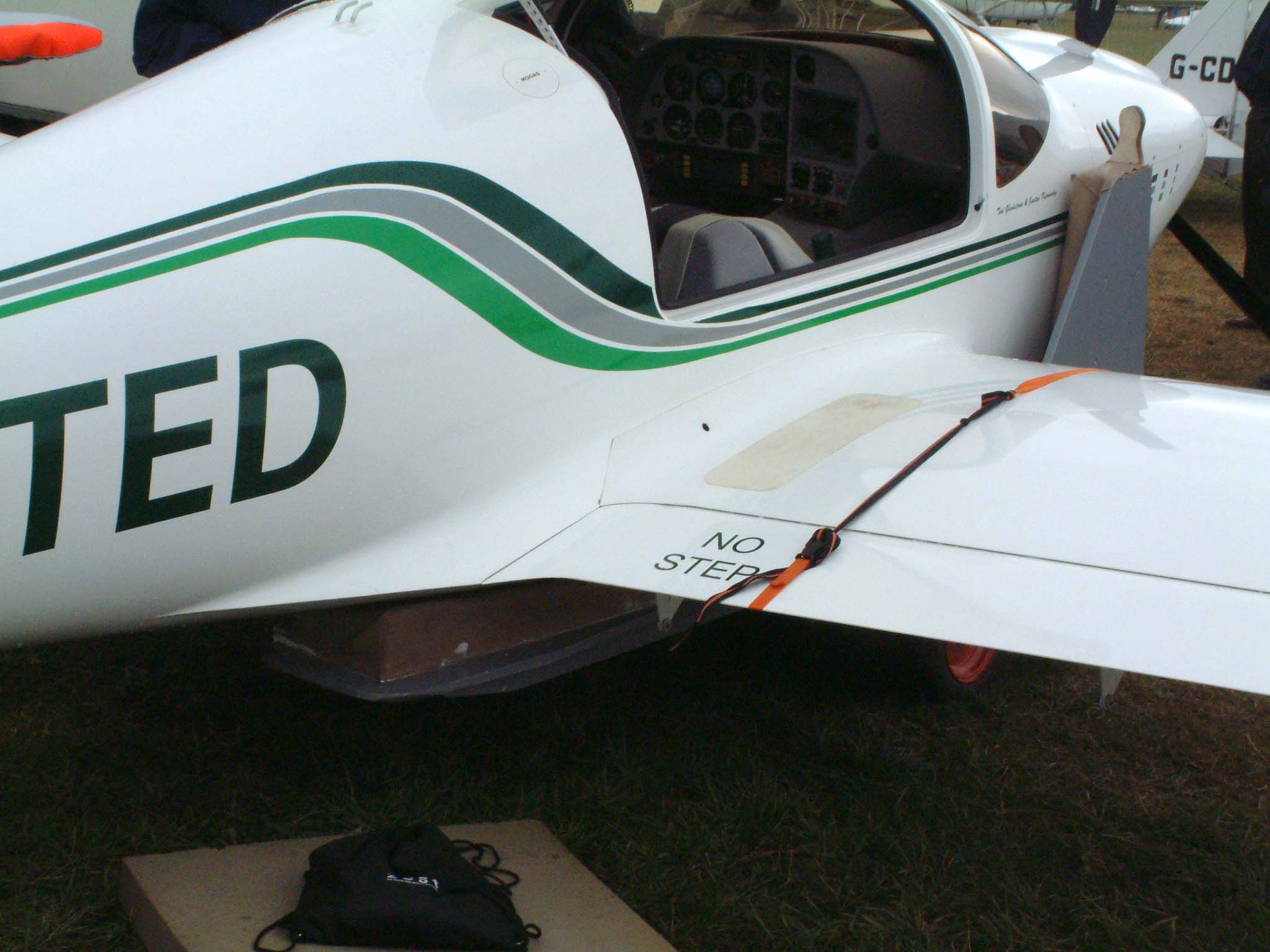

Phil
the nioest wing root I've seen is Ted and Justin's, small radius at the
LE, large at the TE. picture attached. imho this is the way to do it,
the fillet needs to be flexible to allow wing bending without crushing
the fuselage side, so no more than 3 plies of BID at the edge. There are
several Europas with this style but only Ted's has the elegant change of
radius moving aft.
Easier to rig a wing done like this too, something to line up with as it
goes in.
Graham

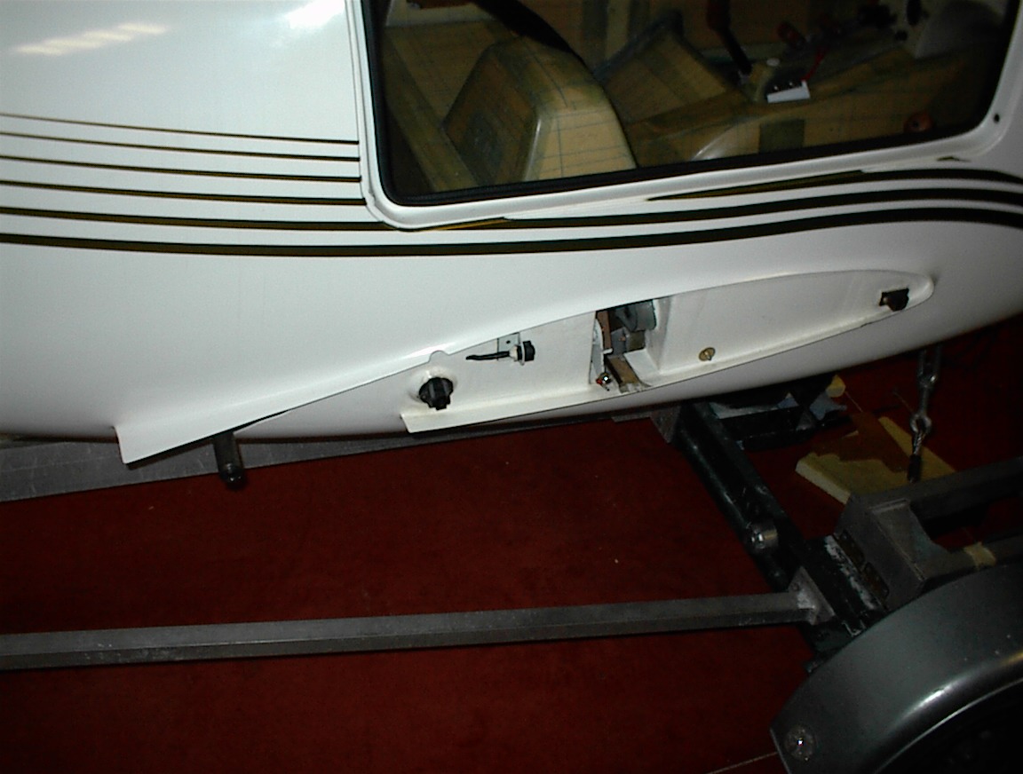

PostPosted: Fri May 11, 2007 1:09 pm    Post subject: Votex Generators Reply with quote
Phil, Graham and all,
In attachment my solution for the wing root drag problem. While building I
fixed the fairing as well to the wing as to the fuselage and cut it vertical
with the wing root. Then I reinforced both to become entire part and
sufficient solid. I also prolonged the upper side at the fuselage to cover
the gap for the flap torque tube so that no spoiled fuel or water could
penetrate the fuselage. This solution gave me some advantages:
- the fuselage is certainly reinforced
- the rigging of the wing is easier because you see exactly were the root
has to meet
- sealing with tape is easy as I did before with my gliders.
Thank you Phil for your much apreciated intervention.
Karel Vranken.
