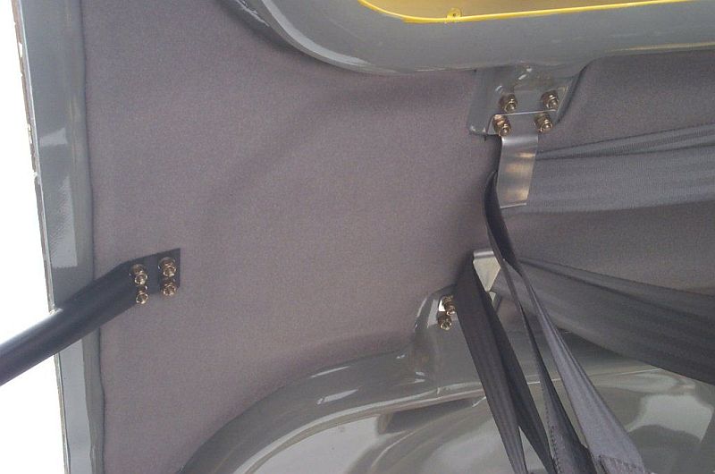

PostPosted: Thu May 03, 2007 7:13 am    Post subject: Overhead Seat Belt Holder Attach Reply with quote
They do bend down some, but just use a little stiffer material
and they'll stay pretty good. They're plenty loose to
just slip the belt in. When solo, I can leave the other
belt in, but the buckles jingle, so I usually pop it out
and let it sit on the back seat. I attached a photo that
I dug up that was in the photos area of my site. It's
the hangers Van's RV-10 has. Mine are a little wider, and
I attached them to the rear door hinge instead of the front,
but the concept is the same.

PostPosted: Wed May 09, 2007 1:51 am    Post subject: Overhead Seat Belt Holder Attach Reply with quote
In response to Mike Kraus' post a couple of days ago I shoot some pictures of the shoulder harness belt holder that I made and installed. It works great and can be viewed at:
http://img215.imageshack.us/my.php?image=sholderbeltholder1dk3.jpg
You can see the angle which I bent into such holder on a brake here:
http://img215.imageshack.us/my.php?image=shoulderbeltholder2zs8.jpg
You can also see the shoulder belts on such holder here:
http://img215.imageshack.us/my.php?image=shoulderbeltholder3vj4.jpg
For storage you can either cross the belts as shown above or just put them on the holder left and right. When flying without a co-pilot or rear seat passengers I keep the shoulder belts and seat belts buckled up so that they cannot fly around if something happens unexpectedly.
