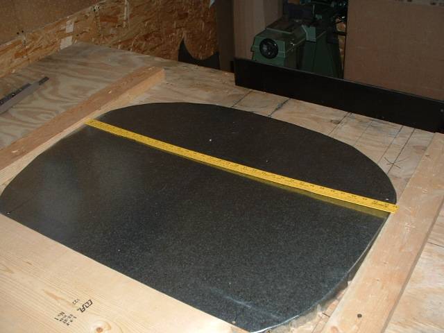

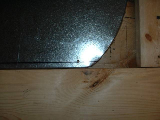

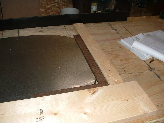

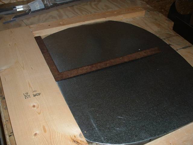

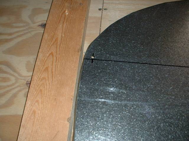

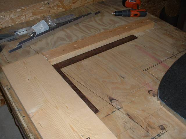

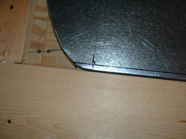

Your eye can fool you when trying to find an edge, but you can't fool a 2x4. Attached are pictures of an idiotproof method (The idiot being me) of locating a firewall centerline to within .5mm. I didn't add text, because it should be self-explanitory. Feel free to e-mail me with any questions.
The existing holes were transferred from the kit part layout and plywood forms. Scratch firewall forming isn't an exact science, which is what worried me.
One look at the "Discrepancy" pictures and you'll see this wasn't a wasted effort.
