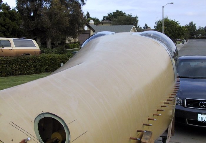

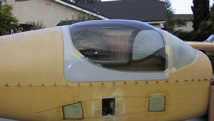

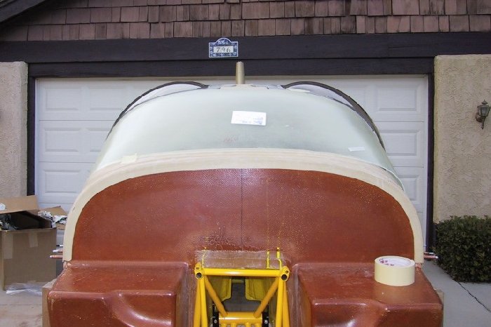

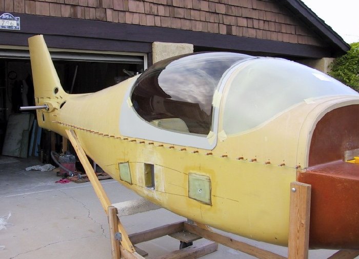

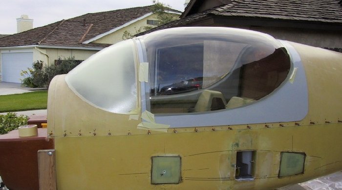

dglauser(at)gmail.com
PostPosted: Fri May 04, 2007 11:07 am    Post subject: Europa Widen Shoulder width door mod. Reply with quote
Hey, that's my Europa!
That is not a photo of the door sill mod. That is a photo of the
bubble canopies placed in position. I was trying to decide if I wanted
them or not. I decided I'd rather have the regular windows, but
haven't yet gotten around to advertising. Anyone want to work a deal?
David

sidsel.svein(at)oslo.onli
PostPosted: Sat May 05, 2007 11:14 pm    Post subject: Europa Widen Shoulder width door mod. Reply with quote
Greg,
You may mix to different mods - the bubble windows (to give more head
clearance for tall pilots, and which I believe must be implemented when
ordering the kit - cannot be retrofitted?) and the door width mod (to give
more internal lateral space.
This latter mod affects only the interior of the aircraft, it does not
change anything on the outside (as the bubble windows do). The interior mod
does not affect the windows, it is only the lower part of the door that is
made thinner and the lower door sill is made more narrow.
Svein
LN-SKJ
PostPosted: Sun May 06, 2007 11:19 am    Post subject: Europa Widen Shoulder width door mod. Reply with quote
The bubble windows are a straight replacement for the original windows
and fit in the standard doors and fuselage. I believe that you're
right in that the three available size-increasing mods (door sills,
bubble canopies, and raised top) are all independent and can be
compined in any combination.
dg
