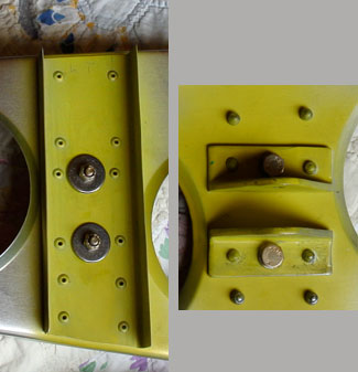

Tim Juhl
Joined: 21 Mar 2006 Posts: 488 Location: "Thumb" of Michigan
Posted: Mon Apr 30, 2007 2:06 pm Post subject: Re: Rivets for Aileron bellcrank bracket |
I took a compromise route. I replaced the middle A5 rivets with AN bolts backed up by a large flat washer to distribute the load over a larger area. I have no idea whether the result is any stronger than the part would be as designed but it made me feel better
Tim
| | - The Matronics Zenith-List Email Forum - | | | Use the List Feature Navigator to browse the many List utilities available such as the Email Subscriptions page, Archive Search & Download, 7-Day Browse, Chat, FAQ, Photoshare, and much more:
| Description: |
| Bellcrank bracket - front and back |
