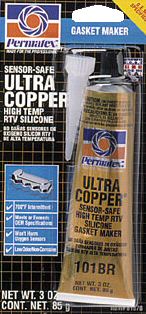

I coat the ball joints with the high temp silicone sealant that is used on the exhaust springs. It makes the joint air tight and stays flexible. It keeps the parts from grinding together too.
Hi Scott,
What sealant are you using? I didn't think any of them were
good to 1200F. Then again, maybe I don't need 1200F protection there.

here it is:
ULTRA COPPER Hi-Temp RTV Silicone Gasket Maker
PERMATEX 81878
Temperature range -75F to 700F intermittent; resists auto and shop fluids and vibration.
Suggested Applications:
Exhaust manifolds/headers, valve covers, oil pans, timing covers, water pumps, thermostat housings
I know it says 700F but it works fine. I've been doing this for many years and probably 350 hours.
Very cool. I'll try it. Thanks.
