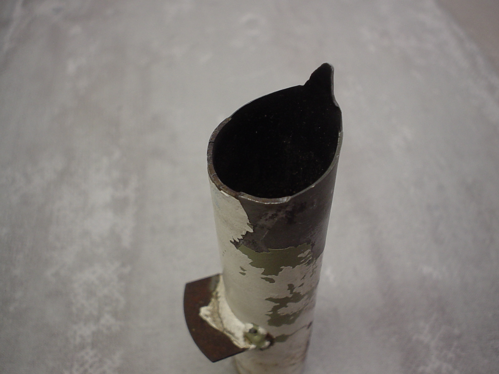

Well yesterday started off great. I went out to the airport with my brother and changed out the radiator and put a shroud on it so he can control the airflow and regulate the temp. We did a runup and burped the system then off we went. after shooting a few off airport landings we headed over to a friends airstrip. The initial touchdown was not super smooth, but nothing to note either. My brother hollers into the headset that the left gear just folded and to hang on its gonna be a rough one.. He hit the mags and held in full right aileron to hold the left side off as long as possible. I see the windshield fill full of dirt then we settle back down right side up.
Shut off gas, made sure ELT was not activated then climb out ( I love the 4 point harness..much better than the single shoulder strap in my pacer when it went in). we pick up on the strut, pull the left gear back under it and tie it off with a short piece of rope then push it off the strip. Turns out, the gear leg had been broken about 1/2 was through for some time as the crack was nice and rusty and the metal was nice and rounded where it had been rubbing and pounding together. This is right where the bungies wrap around the gear leg. I will get a pic of it later on and post it up so you can see the break. I would pull your bungies and get the legs checked out before you get the oprotunity to elevate your heart rate and practice your fiberglassing skills.

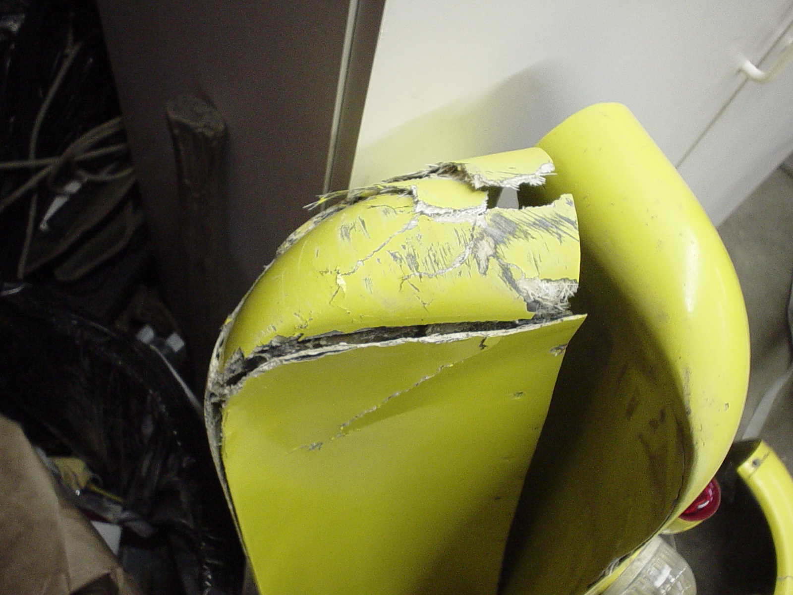

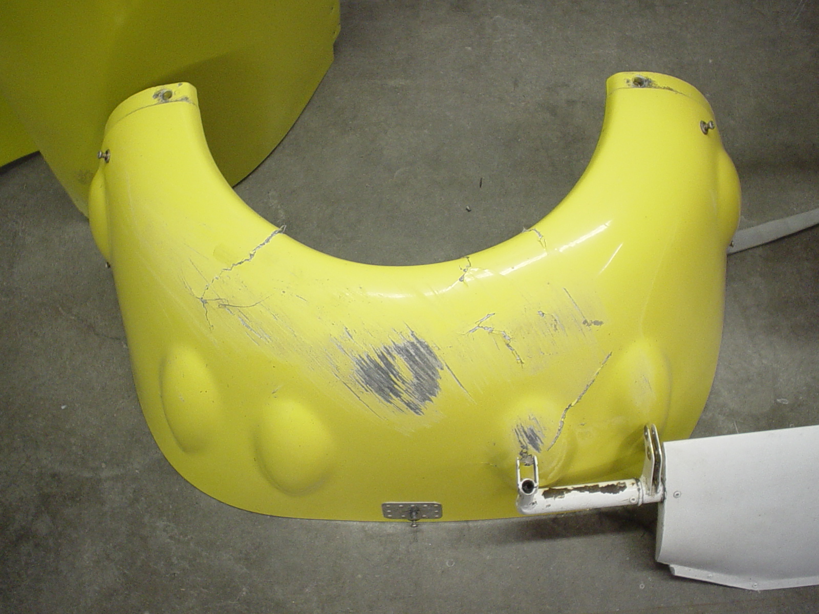

The damage to the plane was cracked both fiberglass wingtips, got 2 blades off the IVO and cracked up the lower cowling. The new radiator and shroud took a good beating but can be repaired and the fuse gets a bit of fabric work to get rid of the new bomb bay hatch the gear leg and wheel installed in it.

Thanks for the grove gear tips... the intent of the post was to make guys aware that there could be a crack in the the gear UNDER THE BUNGIES that you CANT SEE. This post is for those who have the bungie gear in hopes it may save someone a bit of repair time, frustration and possibly harm.

Do you have any photo to share with us? In advance, thank you very much.

the third pic in the original post is the stub of the gear leg that broke off.. You may have to read it onthe forum for it to show.

From: xfire [leonard.perry(at)acsalaska.net]
Thank you, I have now seen your photos on the forum. Scary stuff! I don't understand how it can break at that point but it did, you are the proof of it. Thanks for sharing.

PostPosted: Mon Apr 30, 2007 6:46 am    Post subject: Re: Check your Gear legs Reply with quote
The break was right at the toe of the weld. When I first started welding 4130 I was replacing the tail post and lower longerons on a PA12. The tail cluster was a major PITA but when I got done it looked very nice. I did a dye check and all was well.. 3-4 days later the tail cluster was cracked all up. After talking to the local gurus it was determined that by using the TIG process, the heat affected zone was very small and the 4130 didnot like it. I now preheat to 500 deg. max interpass temp of 700 and when the welding is complete wrap with insulation till it is cooled to room temp. I have never had another welding related issue since doing this.
