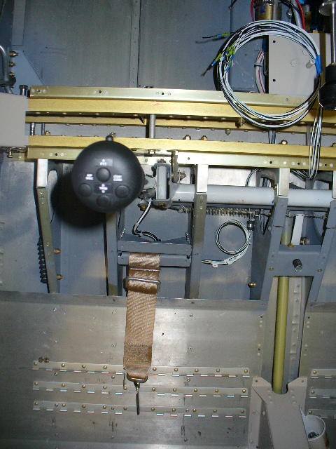

pwatsonfnp(at)comcast.net
PostPosted: Tue Apr 17, 2007 7:28 am    Post subject: get a grip Reply with quote
Hi Don,
My RV7 is nearly done. I have a full IFR panel and both grips have exactly the same switches: PTT on the front, electric trim up and down, auto pilot disengage, and Comm1/Comm2. I have attached pictures of both sticks. My rational for wiring both was for a safety back up. Both sticks are wired independantly so if I lost one side the other may still work as a back up. Down side is you cannot remove the passenger side stick but thats OK with me.
Paul Watson
pwatsonfnp(at)comcast.net (pwatsonfnp(at)comcast.net)

Hi Don,
Paul Watson

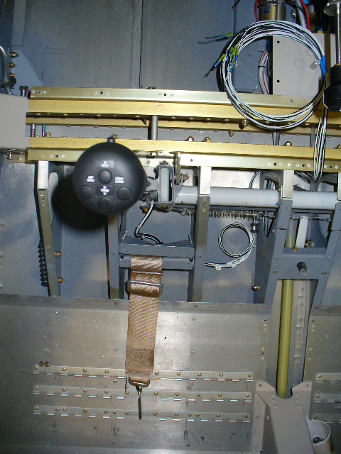

Hi Don,
Paul Watson
