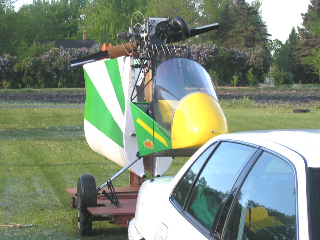

Ralph B
Joined: 14 Apr 2007 Posts: 367 Location: Mound Minnesota
Posted: Mon Apr 16, 2007 8:10 am Post subject: Re: Firestar II trailer.....thumbs |
Try this one. It's 5'X8'.
Ralph

rowedenny(at)windstream.n Guest
Posted: Mon Apr 16, 2007 9:29 am Post subject: Firestar II trailer.....thumbs |
Ralph,
I would think that set up is putting too much load on the tail boom tube
where the support holds it. Any bumps or side loads are going to put a
tremendous loads on the tail.
Denny Rowe

Ralph B
Posted: Mon Apr 16, 2007 9:58 am Post subject: Re: Firestar II trailer.....thumbs |
Denny, I've been trailering on this for over 20 years. The reason it doesn't dent the main fuse tube is because the trailer is a single axle and has enough cushion to absorb the bumps in the road. This design would not work for a large 2-axle trailer and would dent the tube. I know this as it happened to a friend of mine. The pedestal support is 6" X 1" with carpet remnant for the tube.
Ralph

Paul Petty
Joined: 11 Jan 2006 Posts: 226 Location: Mississippi
Posted: Mon Apr 16, 2007 10:25 am Post subject: Re: Firestar II trailer.....thumbs |
Ralph,
Wow 20 years well I guess it's wel proven. Ever had any close calls like it getting blown over? How far and how fast do you go with in?

jbhart(at)onlyinternet.ne Guest
Posted: Mon Apr 16, 2007 11:08 am Post subject: Firestar II trailer.....thumbs |
At 09:10 AM 4/16/07 -0700, you wrote:
| Quote: |
Ralph,
Elegant solution!
Jack B. Hart FF004

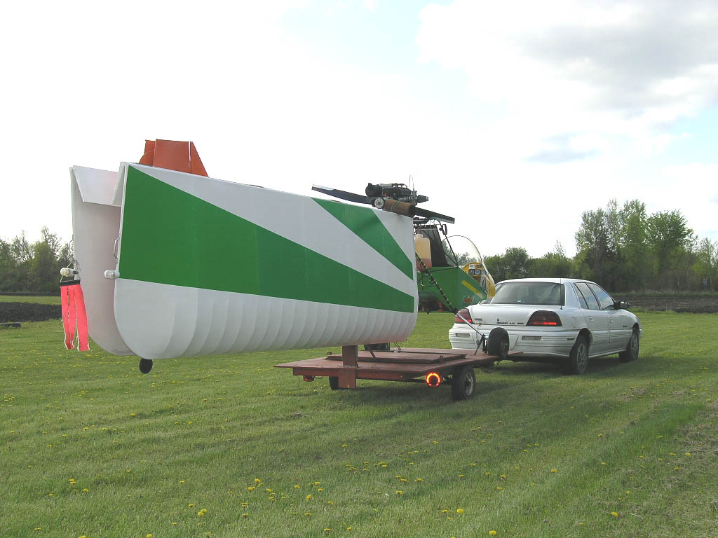

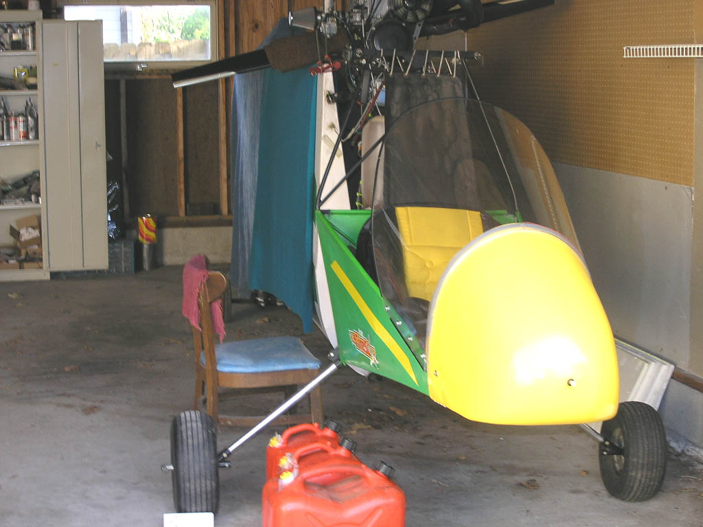

Ralph B
Posted: Mon Apr 16, 2007 11:35 am Post subject: Re: Firestar II trailer.....thumbs |
It's small and easy to maneuver with the single axle. It has negative tongue pressure, which means when I remove it from the ball hitch, the tongue goes up and it rests on the tailwheel. If you think it would be unstable on the road, it's not. This is because the slipstream acts like a huge rudder going down the road and actually stabilizes it. I've trailered though some heavy winds with this. The faster you go, the more stable it becomes. In a good wind I can feel the back of the car moving a little. I only go about 7 miles to the strip, so it's not too bad. I wouldn't want to trailer it for long distances, but I'll bet I could. Here it is in my garage. I haven't ever had any problems with this, but I have to make sure the trailer wheels are chocked and the tongue prop is secure before unloading. If it moves, the wings can get dented easily. I have to be very careful.
Ralph

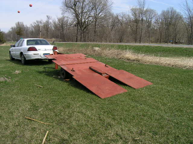

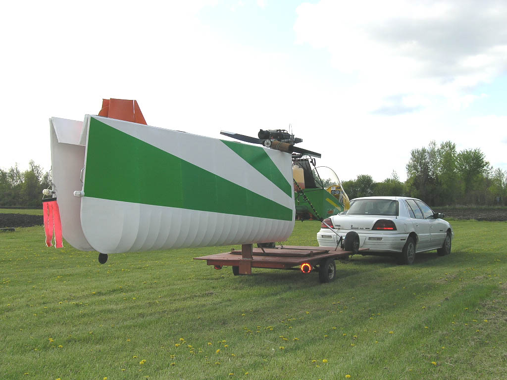

Ralph B
Posted: Mon Apr 16, 2007 6:22 pm Post subject: Re: Firestar II trailer.....thumbs |
I found a few more Firestar trailer pics.
Ralph
