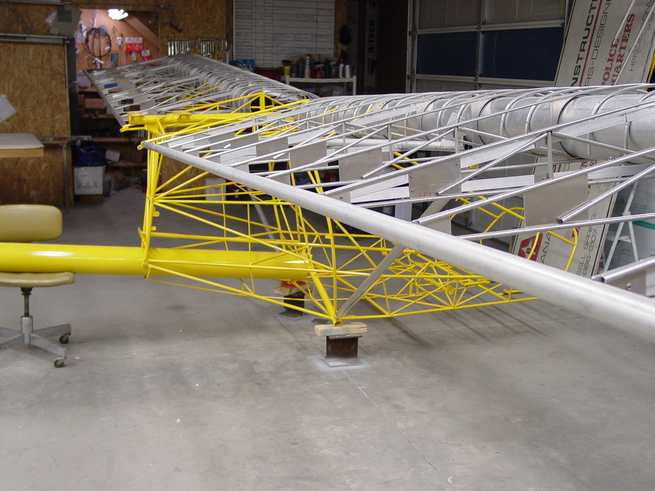

You mean something like this ? It would have been funky looking, but it was so unique and eye catching, that it did not stay that way...
Mike

JetPilot
Posts: 1246
PostPosted: Tue Apr 10, 2007 3:17 pm    Post subject: Re: M3X incidence & dihedral Reply with quote
pj.ladd(at)btinternet.com wrote:
Also is this 1.5deg per wing panel or combined? >>
Hi Scott,
if you change the dihedral angle by 1.5 degrees at each panel you will have
a unique and very eyecatching design.
Cheers
Pat
 Filesize:  330.49 KB
 Viewed:  652 Time(s)
Kolb MK-III Xtra, 912-S

PostPosted: Wed Apr 11, 2007 8:20 pm    Post subject: Re: M3X incidence & dihedral Reply with quote
As near as I can tell from that pic there is at least 6 deg of dihedral on that plane.
I went back thru all the pics I've taken of Kolbs over the years and measured the dihedral angle where possible. I've found anywhere between zero and 5 degrees total over the entire wing. Anything less than 1 degree per wing half tends to look like the wingtips are drooping to me.
Donnie (at) Kolb told me the proper spec for the M3X is 1.5 degrees per wing half. He also told me incidence should be 2.8 degrees.
