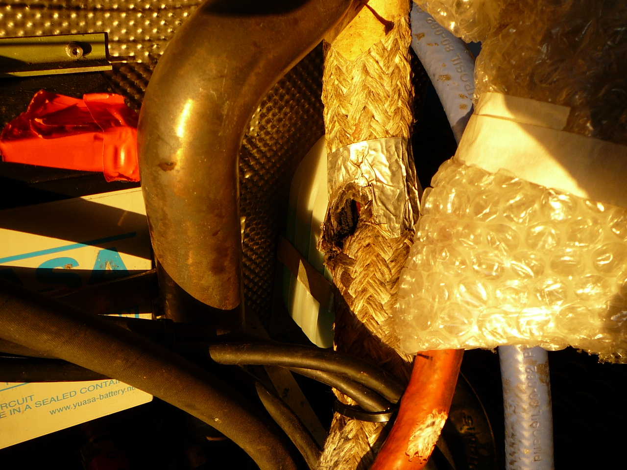

Your timely warning reminds me of a similar but different problem found on my 912ULS at last permit renewal. One of the coolant pipes was found to be burnt by an exhaust downpipe. The damage was confined to the heat shielding which had burnt right through and was about to burn through the rubber hose. Basically, the hose routing was too close to the downpipe - a previous owner had wrapped it up with heat shielding to compensate. An extra reason why this was alarming was that a 912-engined DynAir Banbi in the same hanger had recently suffered a complete loss of coolant through an identical problem (the owner lived to tell the tale but had his wallet lightened by an expensive engine rebuild). I believe Mike Gregory has some gory photos of the damage.

Just preparing to incorporate Mod 72 and took the opportunity to have a good look around.  I found one of the oil pipes badly charred by No1 cylinder exhaust pipe.  The pipe concerned is the one that connects the oil cooler to the oil pump.  Fortunately, when I installed the pipe I fitted some heat shielding from 'Demon Tweaks' - the heat shield was burned through and the pipe was just starting to be affected.
On initial installation the pipe did not touch the exhaust, so the bend must have eased during  use.
Looking at the installation, it seems that a slightly shorter pipe after the bend where it connects to the oil pump should solve the problem.
Hopefully, this is a one off and my aircraft is the only one affected.
But I thought all you chaps might like to know.  It is worth a quick look - a burst oil pipe in this position could be very dangerous.

PostPosted: Mon Apr 09, 2007 10:44 am    Post subject: WARNING - Europa/Rotax 912/914 Owners. Reply with quote
This is one of the ‘gory photos’ Willie referred to, taken of the hose damage on an MCR-01 Banbi fitted with a 912.

PostPosted: Tue Apr 10, 2007 2:34 am    Post subject: WARNING - Europa/Rotax 912/914 Owners. Reply with quote
So... Has anyone got a satisfactory solution to this design disaster??

PostPosted: Tue Apr 10, 2007 4:23 am    Post subject: WARNING - Europa/Rotax 912/914 Owners. Reply with quote
Use silicone Hose instead of rubber with suitable heat reflecting sleeve like http://www.agriemach.com/product_info.php?cPath=0_7&products_id=393
And using slightly longer pieces of hose you can route them further away from the heat source,
But Regular check of hose condition is recommended,
Ivor

PostPosted: Tue Apr 10, 2007 4:28 am    Post subject: WARNING - Europa/Rotax 912/914 Owners. Reply with quote
Hi,
If you take a look at http://europa363.versadev.com/ under January 2004 you can see a few pictures of what I did. I re routed one of the oil hoses to run on the port side of the motor, across the back of the engine mount and up into the oil container. I used Teflon braided Aeroquip 666 hose.
So far this has held up fine for 600 hours.
Routing hoses is an art more than an science.
But achieving a satisfactory result is not so difficult with a little care.
Gilles

PostPosted: Wed Apr 11, 2007 12:25 pm    Post subject: WARNING - Europa/Rotax 912/914 Owners. Reply with quote
Not to mention the bubble-wrap and masking tape "insulation", nylon tie, other cable conflicts and gobs of red insulating tape (also heat stressed and burnt at the edges).
The "cowboy" standard of construction obviously leaves a lot to be desired; but maybe it was "....... all the Inspector's fault....." (if there was one)!
Duncan McF.
