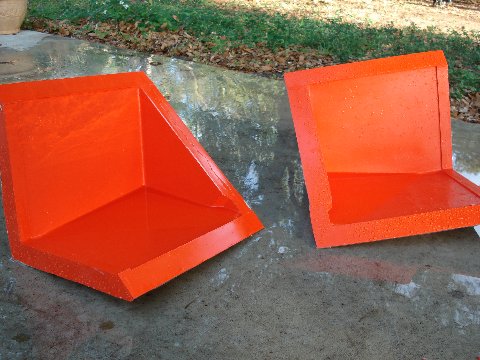

To All,
Just got done building my fuel tank for my Firefly that I pulled from a mold I built last week.
I have not drilled and tapped the holes for the fittings yet but the hard points are in place for a pickup in the small sump in the bottom, a vent in the bump on top and an upper and lower fitting for a sight gauge. Total weight is a mere 2.5 lbs including the Usher Aviation filler cap. It is sized for a direct drop in for the Firefly. I will let you know how it works in a few weeks.

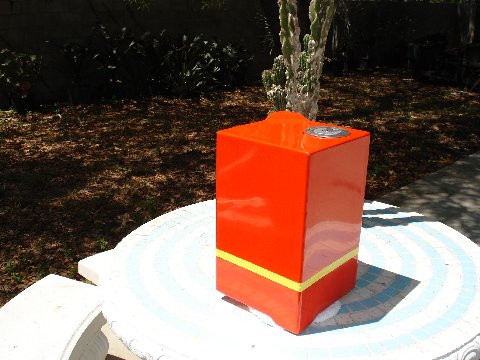

Final assembly!
Thanks Paul,
I have been wanting to build a tank for awhile but did not get to it. Just goes to show you though that it is hard to improve on the original design. I added 1.5 lbs to my Firefly.

Steve
I to am impressed with your workmanship. What type of mo0ld did you make? And what material did you use for the mold?

Thanks Craig, It is a 2 part Split mold that incorporates a joggle to allow for an internal overlap seam. This is a negative draft shape so you have to go two part. The first generation tooling that you see here is what I pulled the parts off. If I need to make more I will pull a Mold Master from these and make a production mold.
I used basic Polyester Resin and tooling quality Gelcoat. The Tank you saw on the past post is actually a trial run to see if everything goes together and a final real version will be made of resins more suitable for gasoline and the newer 10% ethanol fuels.
The lower part of the tank is the same part with the flange cut off. It can be cut to any length to allow for a range of 5 gal through 9 gal.
I understand that you have done quite a bit of glass work so I am interested in your input.

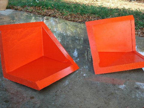

These pics are taken today with the cell phone...
