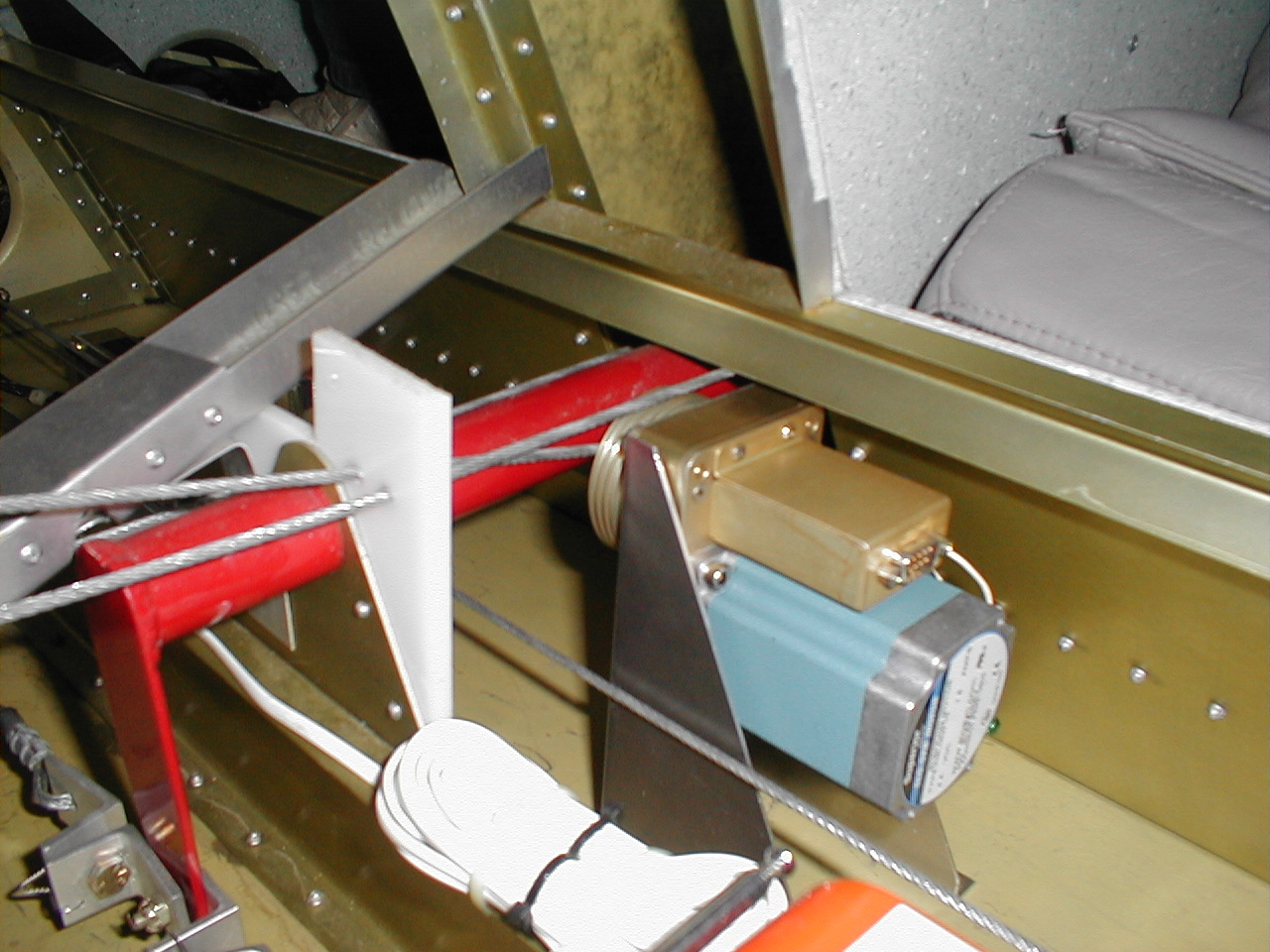

PostPosted: Mon Apr 09, 2007 3:52 pm    Post subject: Re: Aileron cable clearance and installation Reply with quote
Bill and others,
The purpose of the cattycorner brace is there to support the fairlead material that the torque tube and cables run through. I struggled with mounting the brace for a while. My solution was to use a short section of material with the same cross section as the cattycorner brace, flipped over, riveted inside the brace to add strength, which allowed cutting a notch in the brace. See attached photo.
The photo is taken from on top of my ELT which is mounted behind the right seat. (A corner of the ELT is visible.) The seat backs are out, but the right side bottom cushion is in place. The photo was taken while I was installing the pitch servo for my Trutrak Digiflight II. Also visible is the gray speckled Zolatone paint I used for the interior finish of my plane.
Roy
