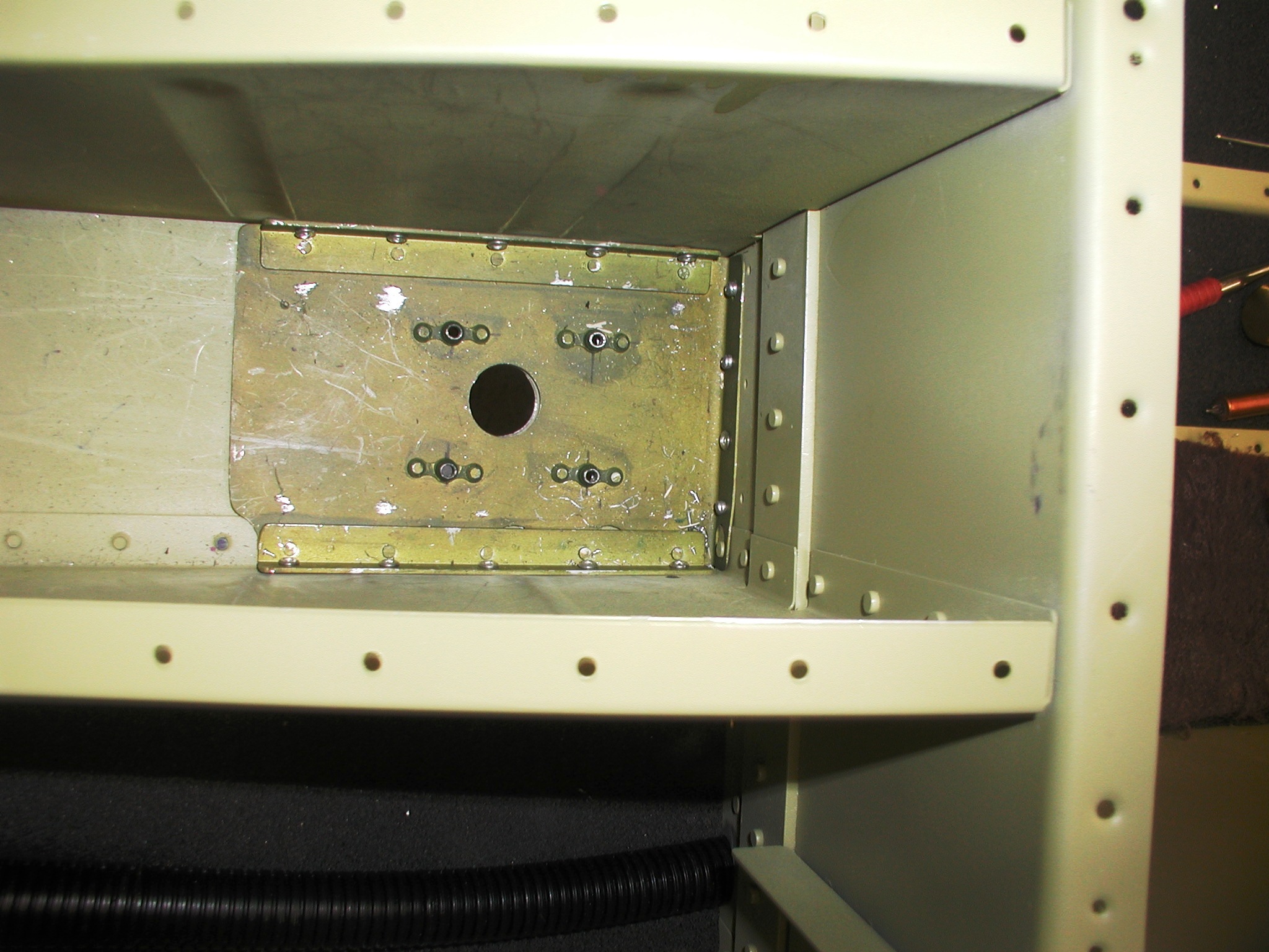

jwt(at)roadmapscoaching.c Guest
Posted: Thu Mar 29, 2007 3:58 pm Post subject: Comant installation question |
Here is my Comant mount under the rear seat. I put the wire in and dropped
it out the bottom and then sealed up the floors. The antenna mounts from the
outside with platenuts.
John Testement
jwt(at)roadmapscoaching.com
40321
Richmond, VA
Paint prep and LOTS of misc stuff
