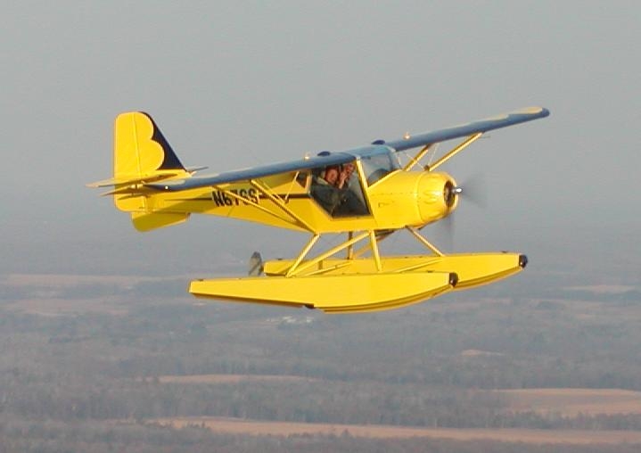

To tell you how well the IVO's perform, get this; My Model 4 amphib (incidentally with only 80 hp) will go 118 mph flat out. Now remember, that is on floats! (see attached pic) My reduced cruise speed (5000 rpm) is between 100-105 mph TAS. And it will climb with me and a full tank of fuel on a warm day at 1400 fpm. I've not found another combination of engine and prop that will do that on a floatplane. So I am pretty well sold on the 912 and the IVO combination. And fwiw - I do have a 912s that I plan on bolting in place of my 80 hp one of these days. And when I do, I will be installing an IVO 3 blade medium on that new engine (can seaplane pilots ever have enough power?) When I have this combination installed you just might see me out flying alongside my Cessna 180 and 185/206 floatplane buddies <GRIN>
