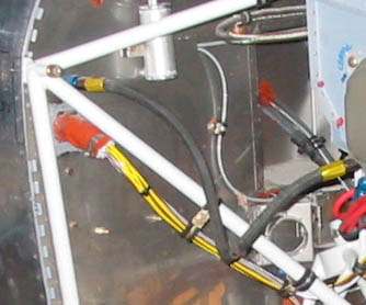

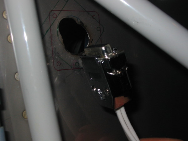

PostPosted: Sun Mar 25, 2007 6:20 am    Post subject: Lightspeed Ignition Reply with quote
I used 1" stainless steel firewall penetration seals. I only had to file the hole slightly larger than I was originally planning to allow the connector to pass through. Pictures attached.
-Jim

I purchased the SS penetration seals and SS heater control valves from:
http://www.epm-avcorp.com/tubeseal.html
By the way, speaking of the heater... Except for the SS heater control valves, I built my heater system per the plans. I went cross country with my RV-10 and a friend in his Piper Warrior last month up to Maine. It was around 15-20F on the ground that day. Other performance issues aside, the RV-10 heater kept my rear seat passengers very comfortable at 9,500'. In contrast, the passengers in the back of the Warrior were quite cold after the 1.5 hour flight. In fact a water bottle left on the floor in the back of the Warrior had frozen. One more reason I love my RV-10.
-Jim
