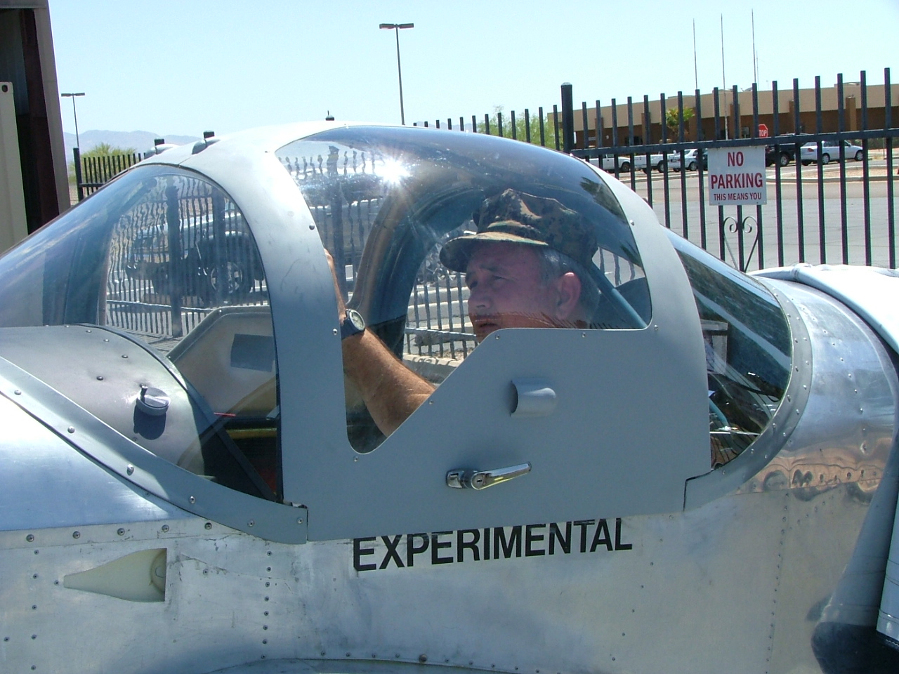

Here is how I fixed mine on the CH600. However, I doubt that most will even attempt such a fix on a 601 - to much work and to much change to the canopy area. Note the frame is also roll-over protection.
Each gull wing door has a simple but very effective latch. I will be able to remove gull doors and fly without them - in fact, test flight will be done both ways. High power fan tests and fairly fast taxi tests indicate that slipstream will not enter cockpit due to shape, location and size of windscreen. Ta Da, it works.
Semper Fi,
Steven R. Hulland
CH 600 Taildragger
Amado, AZ

Steve, do you have more pix inside and out of that canopy of yours? I want to build something similar. Maybe some details on how you built it. I like the look, kind of looks like a F4U canopy. I think I would have made the side extend down a little further. Othere than that, pretty cool. I also like the fact you have rollover protection in there too. Can you supply some pix of that arrangement as well.
