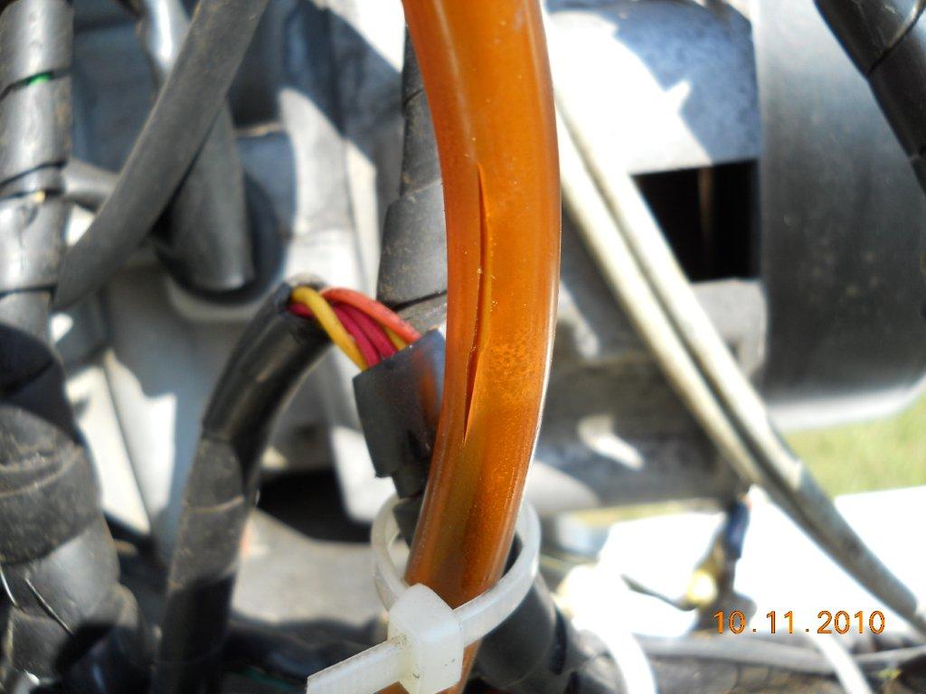

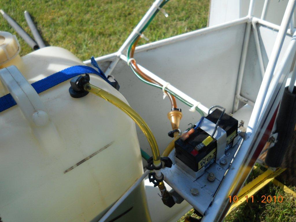

Installed new fuel line 5 months ago... Urethane bought from major parts house.
Had noticed it was discoloring badly... turning dark brown. Today I found an inch and a half split in line between pulse pump and carb. First time I have had a structural failure of fuel line in 9 years of operation... interior deposits yes, material failure no...
Would advise you watch your lines for excessive discoloration, particularly if it happens relatively quickly.
Tomorrow I will take Brother Alexander's advice and install pulse line in place of this garbage...
