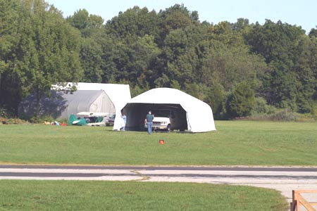

I use a "Cover-It Instant Garage". It's 12' wide X 24' long and 8' high with a round top. I fold the wings on my FireStar and pull it in with a tail wheel dolly. The front end cover has a zipper on each side and after you zip it open, you roll up the cover door, giving just enough height to clear the muffler (with prop in horizontal position). The cover door is then held open by a strap or rope. Very easy and quick to operate. I've been using this for 10 years. Mine is located under a pine tree grove, protected from the elements. My buddy has one out in the open and it is showing signs of wear from sun and wind. However, lately I have been getting a lot of mildew. I suppose because I don't open it up to air out often enough (haven't been flying as much in past few years).
I just checked their web page www.cover-it-inc.com. It appears that they changed the name of company and it's now called Shelter Logic www.shelterlogic.com They can custom make almost any size you need. My cost was $600 10 years ago, with a special free freight because I bought two of them (one for another fellow).

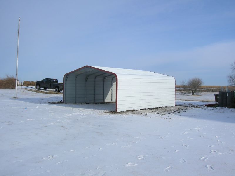

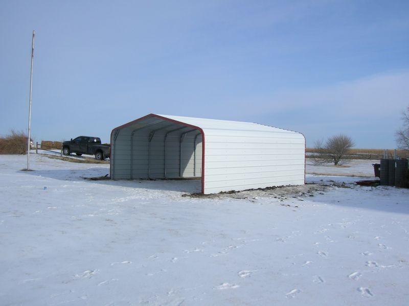

I had a Carports of America building installed in January. I'm sure you've seen them, they have dealers everywhere I've been this last year. Here in Kansas, the base price is $695 for the basic 10' X 18', but that's just a frame and a roof. I bought a 20' X 21' with full sides and an extra frame hoop and the cost was $1700. As I recall, enclosing one end would have been another $600. The frame is 3" square steel tube and the covering is 29 gauge siding. I was concerned about the thickness of the siding, 29 gauge is only .014", but during installation one of the workers was walking on the roof and there aren't any dents or buckles. It has stood up to 60 mph winds already this winter without problems.

PostPosted: Tue Mar 20, 2007 3:09 am    Post subject: Portable hangar? Reply with quote
At 05:52 AM 3/20/2007, Richard Girard wrote:
I had a Carports of America building installed in January...
That looks nice and solid. From the picture it looks like there's no solid
foundation, correct? Just earth anchors or something?

Dana, You're right about the anchors. They're just big spikes, about three feet long and 1/2" in diameter. In Kansas, if it doesn't have a concrete foundation, it's not permanent.
