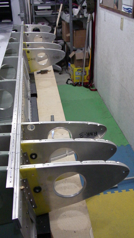

I'm building from component kits and I ordered the 15 gallon tanks with the wings. NR4 is not moved during assembly in my kit, it is left out completely. It wasn't even included in the kit. Instructions said to cut the protruding part of the "L" for NR4 off flush with the remaining portion. They stressed that I not drill the rivets out of the spar.
Also I have seen several 601 wings built with two nose ribs turned web to web and less than an inch apart. One of those I think was originally the NR4 (inboard) but the second one (outboard) is not in my kit either and there is no provision for it. It is not shown in my plans.

I'm building from plans. I'll probably replace NR4 with a hat. and move NR4 outboard of the new tank. That being the case, what's the width of your 15 gallon tank? I take it it's just a stretched version of the 12 gallon tank. I'll make a 15 gallon tank based on the 12 gallon profile and just add some length to it. That way I'll know where to move NR4 to on mine when I reposition it.
30 gallons seems like a good compromise to me. 48 seems like a bit much, plus with 48 I'm looking at 4 tanks instead of 2, which is more hassle, more potential problems due to 2 tanks being empty most of the time (probably not good to have to tanks tht hardly get used), and more fuel management when I'm actually using the tanks.
On the high end for an estimate of 5gph, that's 6 hours of fuel, plenty if I decide to make it into an IFR platform at some point in the future.

The factory installed "L" for NR4 using the factory 15 gal fuel tank is at STA 1770.

Cool thanks. I think I'll make the 15 gallon tank instead. I'll move that L and install a new hat stiffener where it was originally located. They didn't move any other ribs did they. I guess that NR doesn't line up with any of the rear ribs.
What's the actually length of your tank? I would assume that no other ribs moved so it should be just a matter of subtracting NR station at 1770 minus the next inboard NR for a rough length of the tank, no? The reason I'm asking for the length of the tank (or at leat the distance between the ribs it sit inside of) is because in case there were any of changes of rib locations, at least I'll no the length of the tank for it to be 15 gallons vs 12 gallons, assuming the side profile is the same, which I don't see any reason why it wouldn't be.

Ok, so leave the the four inside ribs (wing walk) and then the new tank 15 gallon tank extends from NR4 to the new NR5 which is where the hat is currently.
[quote="Trainnut01(at)aol.com"]Andy
CJ

The 15 gallon tank measures 1270 mm end to end. The "L" for the repositioned NR #4 is moved 260 mm outboard of where the "L" for the 12 gallon tanks was installed. There is no rear rib behind it. The factory built spars do not extend the aluminum bar that runs on the front of the spar top and bottom out to the new position of NR #4 - there is a hat stiffener between the old and new positions of NR#4 for a total of three behind the tank. There are 7 nose ribs in all.
I've attached a pix taken of the bottom of the wing looking out from the wing root.
Tim
Nose ribs (underside) viewed from wing root. Installed to accommodate 15 gallon tank.

Thanks for the info. That's all I needed.
