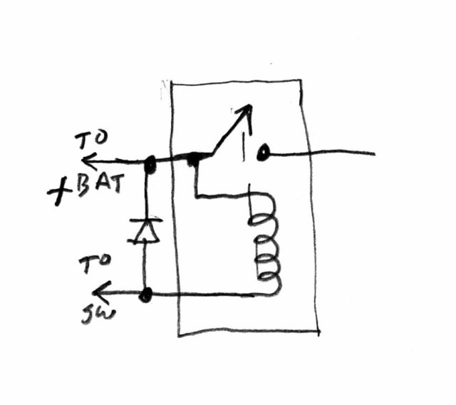

PostPosted: Mon Mar 19, 2007 9:33 am    Post subject: Popped CB Reply with quote
On Sun, 18 Mar 2007 19:49:39 -0400
<frank.phyllis(at)mindspring.com> wrote:
<snip>
The diode can be inside or outside . . . some of my drawings
show it inside because the starter contactor I used to sell
had it built in . . . but you can put one on the outside.
Is it possible to put a diode on the outside of a three connector relay?
<snip>
Frank
Hi Frank,
As best I can tell, this question wasn't addressed so I will take the
liberty of replying.
Yes. One side of the coil is connected internally to the contact that
goes to the battery, and the other side of the coil is grounded by a
switch on the panel. To put the diode across the coil, connect the
cathode to the battery contact and the anode on the coil terminal.
small sketch attached.
Bob W.
N93BD - Rotary Powered BD-4 - http://www.bob-white.com
First Flight: 11/23/2006 7:50AM - 3.8 Hours Total Time
Cables for your rotary installation - http://www.roblinphoto.com/shop/
 Filesize:  19.12 KB
 Viewed:  314 Time(s)
