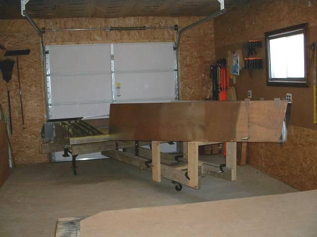

All-
Well, here we are. 3 months late (Some might say 3 years late), but the fuse is hooked up to the c-section. Just finished the garanger and still have to be careful of positioning or I'll run out of room!
Anyone have an easy way to bend the upper longerons? I'm not crazy about building the rig Larry Mac used, but will if I have to.
Bill Naumuk
HDS Fuse/Corvair
Townville, Pa

I guess it's the casters that threw me.
Bill Naumuk
