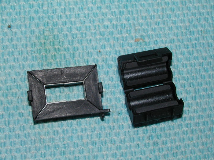

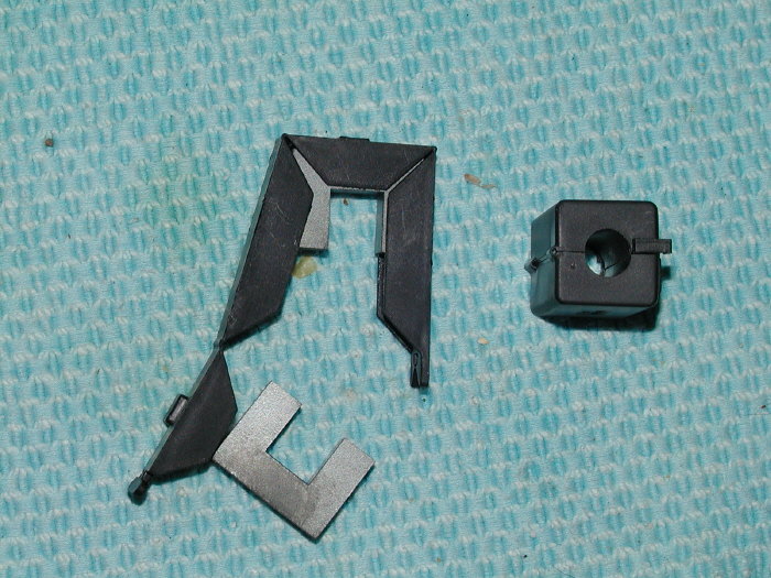

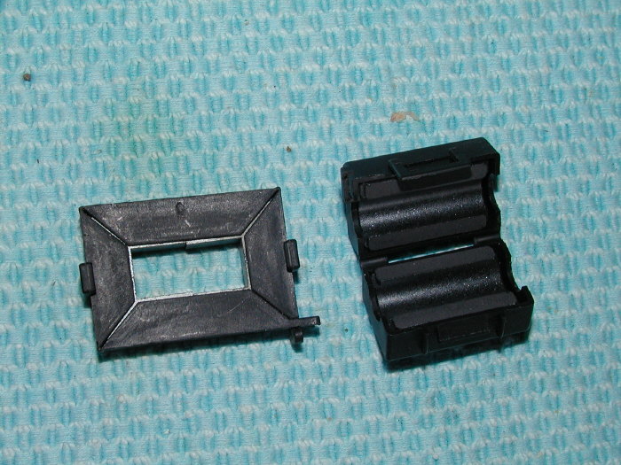

You may remember I was having problems with my radio having lots of static with a new engine change. I received suggestions that I get a rf capacitor to stop it. I was unable to do so without going on line and ordering one. I generally have a bit of trouble buying something that I can't examine. ( we all have our quirks) One of the problems that I had with an earlier version capacitor was that it screwed with my RPM's on my EIS. So I called the gal at EIS and asked her about the problem. She told me to change to the gray wire out of the rectifier, but that it would cost me the check for one of my mags. She mentioned a RF choke from Radio Shack that should do the job of cutting out the static interference. The numbers are 273-105 and 273-104. Look them up on the Radio Shack web page. Most all the Radio Shack stores carry them unlike the capacitor. The cost for both is under $15.00. They work by wrapping the wire around one of the chokes and the other works by just passing the wire through it. In a conversation with Roger Hankins, I found that the choke will eliminate the necessity of matching your RG cable length to the antenna. I cannot tell you any more about this aspect, perhaps Roger can clarify that.
The weather finally moderated enough to allow me to fly today, so off into the wild blue I went with the wife giving me radio checks on the ground. I am pleased to report that there was "minimal" static with the use of these, and it APPEARS that the distance has been increased dramatically. I caped appears, since there has been no exhaustive testing done. The only thing that I can tell you is that before the chokes I could only talk to her from about 8 miles. This time there was no noticeable difference in quality at that distance. Good enough for me, you can make your own deductions.
I did have to remove the power wire to the 196 gps though. My choke is placed on the main feed wire from the battery to the main power bar. All the power originates there through the master switch. The GPS power wire makes a static build up that culminates in a "pop", then builds again. Karen can't hear it, but it is quite loud in my head phones. I will wrap the power wire around a choke and see if that helps. If not then I guess I am going to have to buy some stock in Delco batteries.
