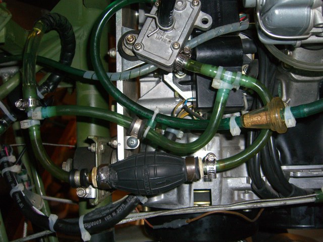

Ok guys,
Would you plumb in the primer "tee" before or after the squeeze bulb?
Also, on my Kolbra would you run the primer to the cockpit or underneath the engine?
Really don't like the fuel up front with me........
Your thoughts....
Wayne
Wish I lived in the American REPUBLIC!!!
David.Lehman
Posts: 265
Location: "Lovely" Fresno CA
PostPosted: Wed Feb 28, 2007 7:18 am    Post subject: Primer versus Choke? Reply with quote
Picture's worth $.02 of words...
DVD

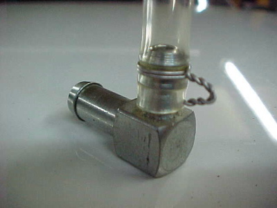

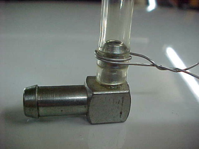

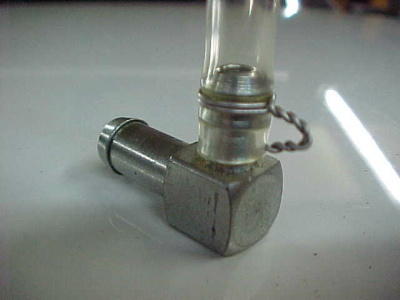

Richard Pike
Posts: 1671
PostPosted: Wed Feb 28, 2007 8:06 am    Post subject: Re: Primer versus Choke? Reply with quote
Really nice arrangement David. Let me throw in my $.02 worth - I am not all that crazy about tie wraps as fuel line clamps, I really prefer something that will clamp the tubing in such a way that the soft tubing is pushed extra snugly around the barbs of the fittings. I am not convinced that tie wraps will do this, and I am convinced that most hose clamps do not apply even grip pressure for the full circumference of the tubing.
Here is what I use instead of either of them, details on this page:
http://www.bcchapel.org/pages/0003/pg13.html
Richard Pike

David.Lehman
Posts: 265
PostPosted: Wed Feb 28, 2007 8:23 am    Post subject: Primer versus Choke? Reply with quote
Richard, I totally agree...
The tie wraps are on their way out... My whole fuel system is safety wired except for that area, which I need to change (most of it was plumbed before I bought the engine)... The plane's in my garage this week so that I can finish up my Navman installation and get flying Saturday...
Thanx for the advice...
Looks like a neat installation. Only thing I don't see is how the bulb can
draw anything from the tank unless the bypass line is pinched off... is
that what you do?
-Dana

Dana...
It's magic...
Seriously, I agree it shouldn't work without pinching the bypass line, but... Apparently the bulb produces more flow than the bypass can handle, so it still fills the carb. bowl (bowls, when I had the two carbs. installed) without pinching the bypass line...
DVD

Re: safety hose clamps. I've used soft copper instead of
steel...won't cut fuel line, and easier to use on smaller lines. Fire
away, gridleak.
