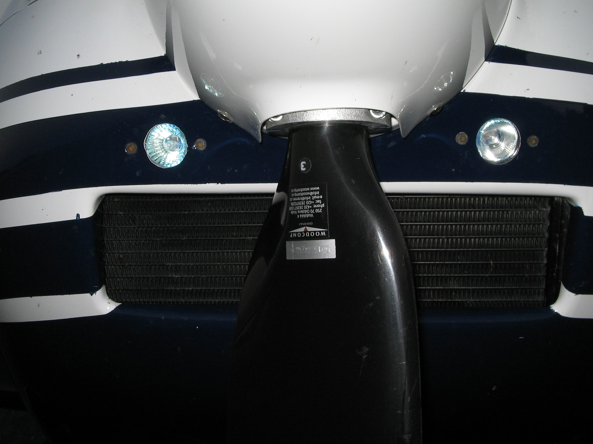

i have installed 12v halogen bulbs from home on my 601 same could be done on 701
mounted them in a perspex housing total costs 3,--usd
