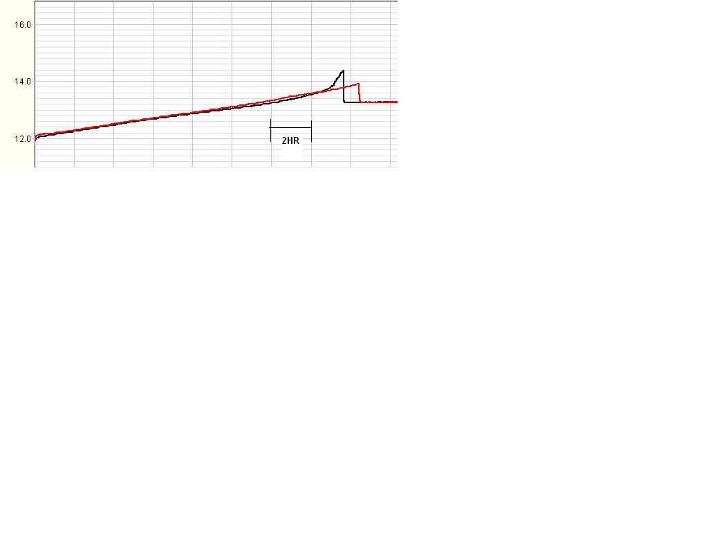

The second battery recharge using a Battery Tender completed
this morning. The attached image shows the first and second
recharge voltage curves. The first curve is in red, the second
in black. I note that this charge cycle ended earlier (battery
wearing out? It's several years old) but the charge cycle extended
into the end-of-charge voltage inflection. Given that devices
like the Battery Tender probably use analog comparators to
sense when states change, the earlier curve may have terminated
a tad early on noise . . . nonetheless, it appears that these
whimpy little 'chargers' may be quite capable of stuffing all
the snort back into an SVLA battery . . . all it takes is patience.

Hey Bob,
Glad to see the Battery tender junior re-gets your
endorsement...Especially as I'd just bought one.
This device looks pretty useful, I could imagine using it in flight to
gather all sorts of data or to compare to a suspect engine monitoring
system for example.
The only issue I see is the analogue inputs are not rated up to 14v (10v
was the max) but somehow you have been measuring the full charging
voltage...How did you do that?

Isn't the real value of an intelligent charger simply that it prevents
or limits overcharging and battery damage? I suspect that any charging
scheme that prevents overcharging is 99% of the answer regardless of the
exact programming algorithm. A wall wart and an LM317 voltage regulator
set for float voltage for example has worked well for me for many years.
Since the current at float voltage (self discharge current) seems to end
up the same, I'm confident that the slow charge is fully charging the
battery and that I'm not overcharging. As noted , limiting the voltage
really only slows the last few percent of charging.
Yes . . . for sustaining a battery in storage, you support
the battery at or slightly above the stable open circuit
terminal voltage which is on the order of 12.9 to 13.0 volts
at room temperature. To fully charge a battery at room temperature,
13.8 volts will eventually do it but to speed things up toward
the end a shutoff/top-off of 14.0 to 15.0 volts is not uncommon
for smart chargers.
Well, I can try it out and see. On one of the recharge cycles
I'll set it up on a constant current power supply limited
at 13.0 volts and see what kind of energy the battery accepts.
