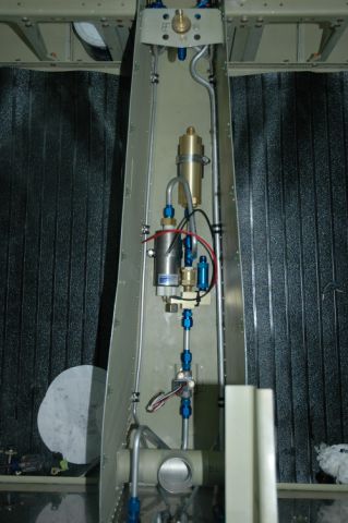

This came up yesterday when a list member called me. It is quite a pain in the neck to get all of those little short lines between the filter and pump, then from the pump to the floscan. We realized that it would be easy to rearrange the brackets on the tunnel floor so all 3 of these parts are directly aligned. That way the lines between them are just straight stubs of line with flared ends. Is there a reason that this is not a good idea? It is not a difficult modification, but I want to know if I am missing something.

Would you worry about thermal expansion of the straight sections putting stress on the connections. At least those runs with bends in them have something to flex slightly.
Getting the straight pieces cut exactly the right length might also be tougher to do.

The AC 43.13 gives the reason for angles and bends in rigid tubing (flex tubing as well) as a dampener for Flex and improved connection between two devices that happen to be Inline.
When the B nut or the ferrule chafe from vibration, flex or pressure change, it is becomes much easier to understand the directive.
