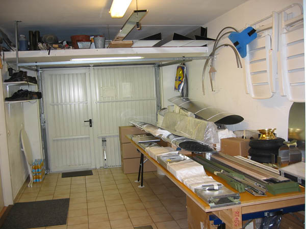

Terry - Check out Andre's site (courtesy of ch601.org)
http://home.tiscali.nl/a.vandenelsen/foto%20pagina%20's/begin/index.html
(Make sure to get the complete URL)
Chris in Seattle
