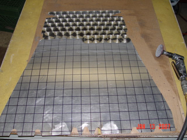

Here Fishy Fishy fishy....
I've got some pictures of the process here...
http://wingsforum.com/viewtopic.php?p=5126#5126
Their easy to do , but I have a couple of "tips"
Gotta Fly...
Mike & "Jaz" in MN

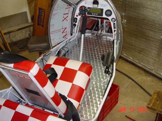

Boy PlaneCrazzzy has too much time on his hands. Too many Z's in his name too. I'm jealous as hell though. I want that enclosure and the fish scale floor pan, and the checkerboard seat cushions. I better get busy and earn some Z's for my name too.

Those fish scales were done in only a couple of hours....
And I sewed my upholstery on a regular sewing mach....just bought upholstery thread & needle....
It's gonna take a little more for the windscreen....but the same thing could be done by just bolting /Riveting it together....
Main thing is....get inspired....make a wish list of things "ta do"
Gotta Fly...
Mike & "Jaz" in MN

Hi Mike
I am curious to what type of tool you used to do the fish scales ,it looks
like a sanding disk, would you please elaborate?
Thank you in advance
Bill Vincent
FS II
Upper Peninsula Michigan
_________________ Bill Vincent
Firestar II
Upper Peninsula of Michigan |
| Back to top |
planecrazzzy Guest
Posted: Sun Jan 14, 2007 3:37 pm Post subject: Re: Fish Scales....Floor pan first....Then? |
Hi Bill,
It's an angle grinder with Scuff pads (2") The WD is put on to avoid
build up on the pad which would start gauling the aluminum....
The way I laided out the piece was about 1"x1" ( a little bigger )
In one row , I would center the pad where the lines crossed....
In the next row , I'd center in the middle , between the squares....
Next row , back on the crossed lines....
Below is a picture with the air tool in it....
Gotta Fly...

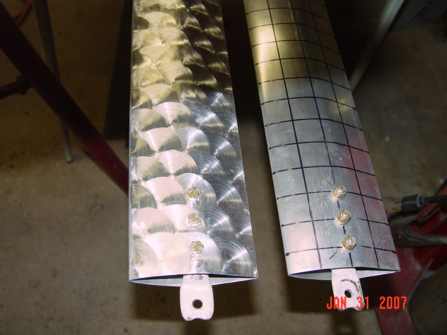

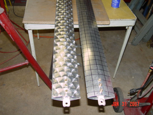

Well,
After looking at my Lift Struts....I've tried to polish them .... But they have to be handled so much , they get scratched up....
What hides scratches.....
These things weren't easy to do because of the curve that I'm trying to go around...
http://wingsforum.com/viewtopic.php?p=5291#5291
Gotta Fly...
Mike in MN
