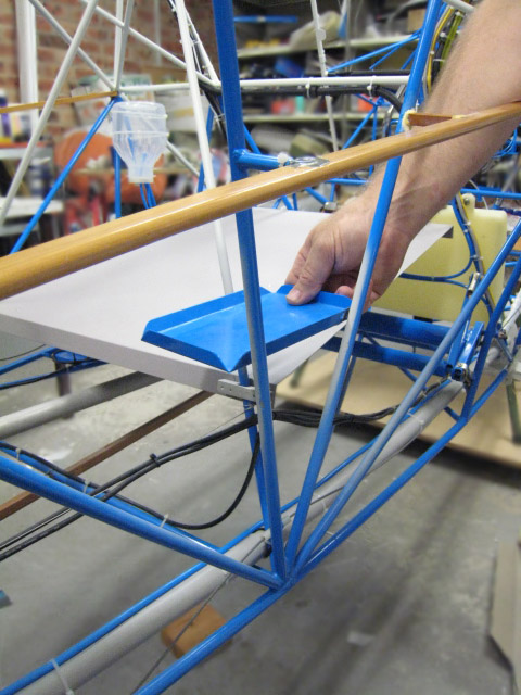

The last job I did in preparation for the inspection, was to remove the old rear-mounted battery tray. The tray had been welded in place at the factory, between three braces on the right side of the fuselage. There were two small weld beads on each side of each brace, which I cut through using a very fine cutting disk.
The fuselage had been powder-coated at the factory.

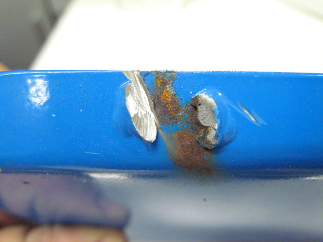

After removing the tray, I noticed that both the tray and the three braces showed significant rust where they touched. The powder coating had not penetrated or sealed those contact points, hence the surface was left unprotected, and oxidation had started. The surface of the braces was pitted. Had I not discovered this, the rust would have continued to the piont at which the integrity of these braces may have been compromised. The kit had been stored for many years in a very dry location prior to our purchasing it, hence this limited the progress of the oxidation. Once the aircraft began operations however, the amoint of moisture able to get into thease areas would have been much higher, so I believe that the speed of oxidation would have increased significantly and, because of its location, would not have been easily noticed.
I suggest that anyone with a battery tray that has been welded in place at the factory, especially if their fuselage was also powder-coated, should check the brace contact points closely. Standard spray painting would not guarantee that these areas were properly coated either, due to their akward position.
The rust shown on the battery tray edge in photo #0121 is similar, but slightly less than what I found on the brace where the tray contacted it. Sorry, but by the time I thought of getting the camera, I had already cleaned and primed the brace tubes.

Two ways to prevent rust in this location. 1) Use the plastic box in the kit which has a closely fitting top with a vent to relocate the fumes from a flooded cell battery. 2) Use a sealed battery. The sealed battery is especially good as they use a plastic case which does not let battery vapors out from inside the battery. In this case the Skystar plastic box is not necessary.
In any case a small amount of rubber vetween the battery or plastic box will keep the paint from wearing off due to vibration.
Of course if you are criticizing the weld integrity then all the welds would be subject to similar corrosion. I dont think the batt tray is peculiar to bad welds where paint that did not seal the weld. Anyway It is my belief that battery vapors is the root cause of corrosion. Otherwise other welds would have the same problem.
BTW, Powder coating will not cover a weld defect. Any significant pin holes or cracks would not be sealed by the process.
Regards, Paul
