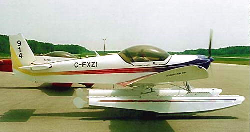

PostPosted: Tue Jan 09, 2007 4:54 am    Post subject: 601 HD with Rotax 914 Reply with quote
She works like a charm
Mark Townsend Alma, Ontario
Zodiac 601XL C-GOXL, CH701 just started

1/8/2007 4:12 PM
 Filesize:  18.82 KB
 Viewed:  435 Time(s)
