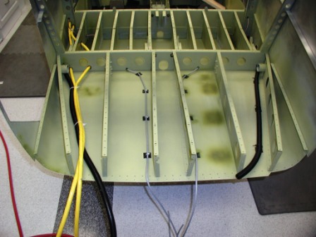

jwt(at)roadmapscoaching.c Guest
Posted: Sun Dec 31, 2006 8:27 am Post subject: Strobe wiring. |
John,
I put my strobe power supply to the right of the battery and ran the wires
to the wing as far as possible from the other wiring to avoid the noise the
strobe pulses can put off. I ran the wires 2 bays to the left and the right
of center and then out thru holes near the flaps. I ran the strobe wires
separately through the trailing edge of the wing.
I have attached some photos. The one of the fuse outside shows where the
strobe wire exits - a little hard to see..
John Testement
jwt(at)roadmapscoaching.com
40321
Richmond, VA
FWF, engine, wiring
