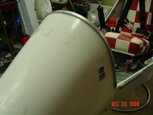

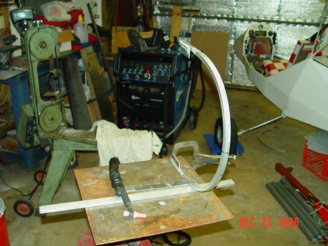

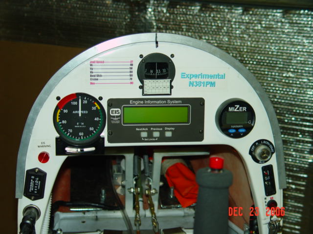

Hey Guys,
I started working on my Full Enclosure today....
I'm off work til next year ( use it or lose it )
Anyway , out in the garage using my NEW Tig machine to weld the
aluminum angle contraption.....I had a little over 400lbs of Argon , so I
figured it would get me over these next 3 days....
I got most of the nose cone piece finished....I was going to add a little
weld to radius a corner....Weld was coming out dirty......What the......
Checked my gas......said 400lbs......Hit the button.......Nothin
Ran out gas , seems the flow meter gauge that came with the Tig
machine is a little on the cheap side.....
I've got a few pictures to share.....
"My" full enclosure is going to be done in sections.....That way pieces can
be changed easy and cheaper than replacing the whole thing...
in the pictures is my Front mounting bracket for the main wind screen...
It'll have two main tubes welded to it , and doors will hinge off of them,
or Fly without the doors...
Gotta Fly...
Outside view of angle
 Filesize:  56.87 KB
 Viewed:  536 Time(s)
I'll be bolting it to the existing holes
 Filesize:  59.73 KB
 Viewed:  562 Time(s)
 Filesize:  60.63 KB
 Viewed:  534 Time(s)
First step....I rolled Channel aluminum at work....Then after the shape was close , I cut off one of the flanges - made it an angle
 Filesize:  60.9 KB
 Viewed:  479 Time(s)

PostPosted: Sat Dec 23, 2006 7:54 pm    Post subject: Full enclosure Reply with quote
How are you forming your curved surfaces? They look beautiful.
jerb

PostPosted: Sun Dec 24, 2006 3:07 am    Post subject: Re: Full enclosure Reply with quote
Hi Jerb,
Thanks for the complement !
The Main shape was done buy taking a piece of Aluminum "Channel"
( square - not tapered flanges )
I put it through a "Roller" at work ....curve it alittle , lower the roller,
do it again until I got the radius that was close..... From there it was a
matter of hitting it with a deadblow hammer against wood , to get the
shape even closer.
After I got it's shape as close as I could , I then cut off one of the
flanges....and used the deadblow / wood to fit even closer....
Trying to do this with angle from the start is a mess .....
The channel really helped....
After the basic shape was done , I used my TIG to do the detailed wrap
around for bolting it in the existing holes....
I'll probly add two bolts around 10 & 2 O'clock
(Stainless bolts because of the Compass)
. Gotta Fly...

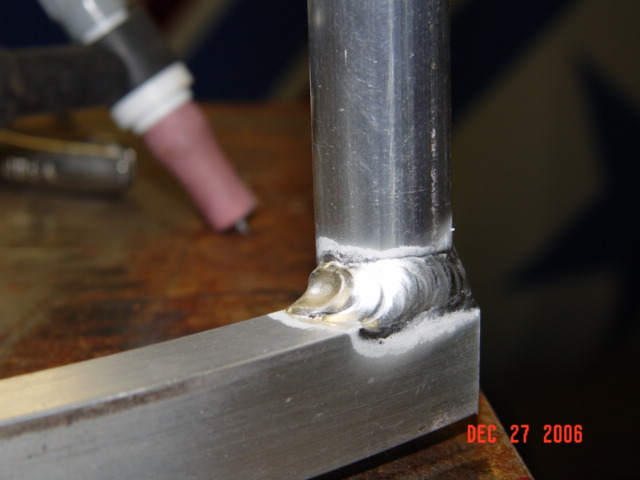

PostPosted: Wed Dec 27, 2006 6:22 am    Post subject: Re: Full enclosure Reply with quote
Hi Dwight,

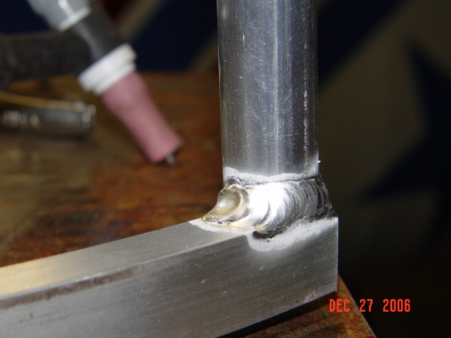

Well, since you mention it.... I have something written about it.
It's on the Tailwind section because I mainly bought it to build my next plane ( Wittman - Tailwind - W-10 , 320 lycoming - cruise 190-200 )
Here's the address:
http://wingsforum.com/viewtopic.php?t=4184
[quote="Dwight Kottke"]Hey Planecrazzy, nice pictures, especially the one with your new welder in it. Tell us more about your new toy.
The Flying Farmer [b]
Gotta Fly...
Some of the welding involved in my next plane....It's gonna be fun !
 Filesize:  47.73 KB
 Viewed:  499 Time(s)

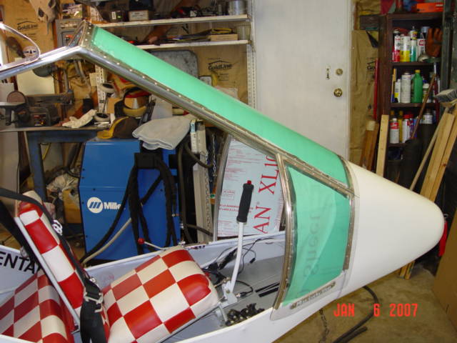

 Filesize:  60.11 KB
 Viewed:  466 Time(s)

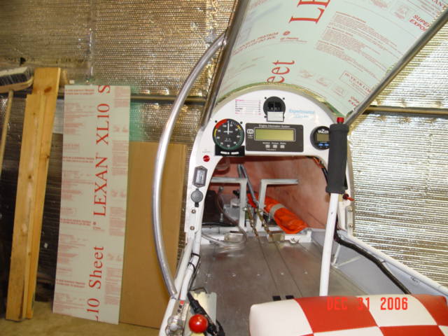

planecrazzzy

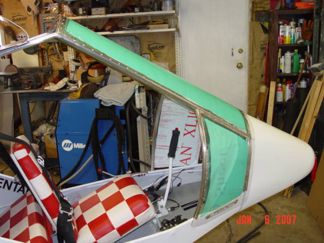

PostPosted: Sun Dec 31, 2006 12:56 pm    Post subject: Re: Full enclosure Reply with quote
At this point , it's "Flyable" , But not done yet ...
Working on the Front / Side pieces now...
Update :
http://wingsforum.com/viewtopic.php?p=4965#4965
Gotta Fly...
 Filesize:  60.41 KB
 Viewed:  487 Time(s)

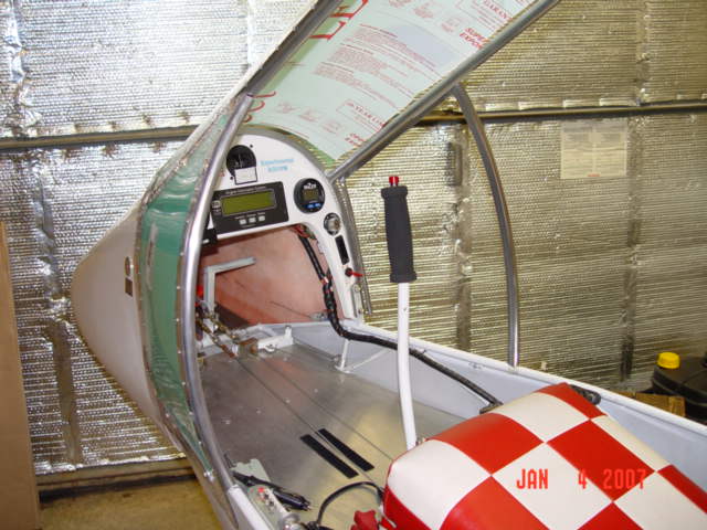

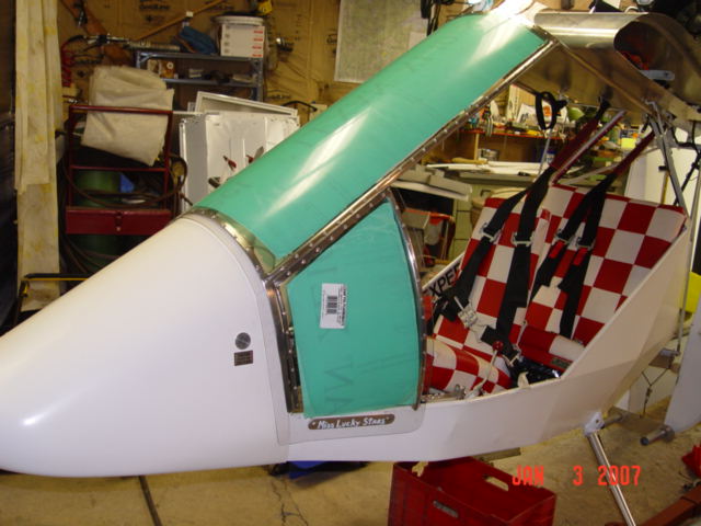

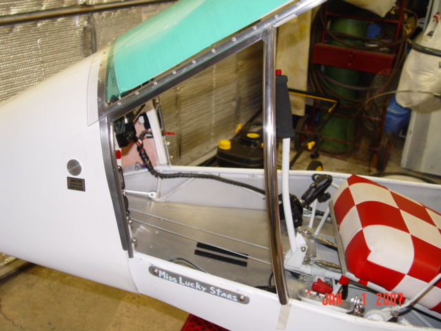

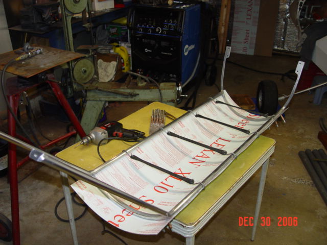

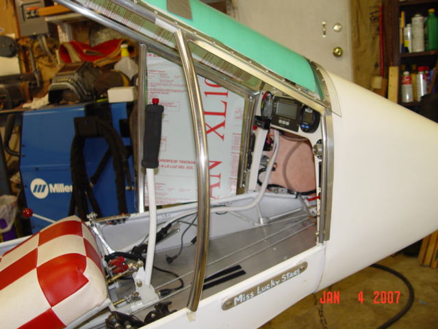

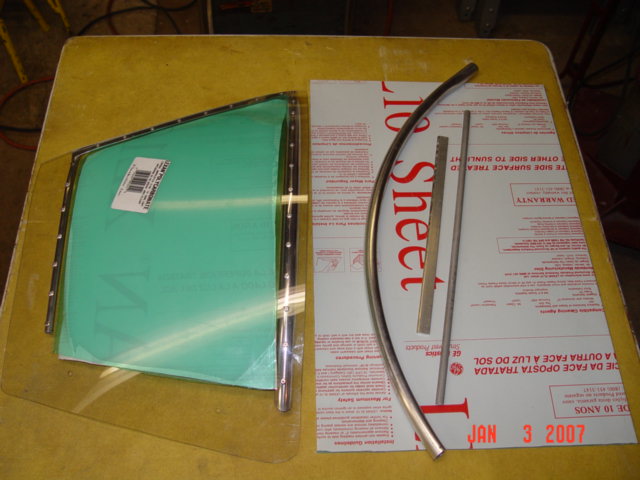

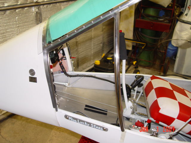

PostPosted: Wed Jan 03, 2007 4:23 pm    Post subject: Re: Full enclosure Reply with quote
Here one of the Front sides done...
Gotta Fly...
 Filesize:  59.74 KB
 Viewed:  461 Time(s)
Now I've gotta make the other side
 Filesize:  59.73 KB
 Viewed:  471 Time(s)
planecrazzzy

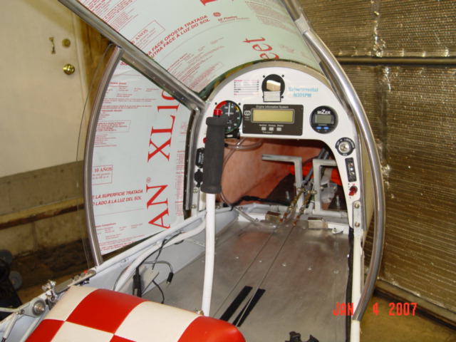

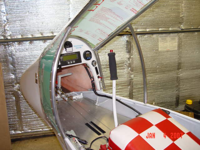

PostPosted: Thu Jan 04, 2007 4:36 pm    Post subject: Re: Full enclosure Reply with quote
Other Frame is done...Still need to "fit" the lexan.
After this side piece is done , I'll be working on doors ....
I'm not sure how that's gonna go....I need the wings unfolded.
Gotta Fly...

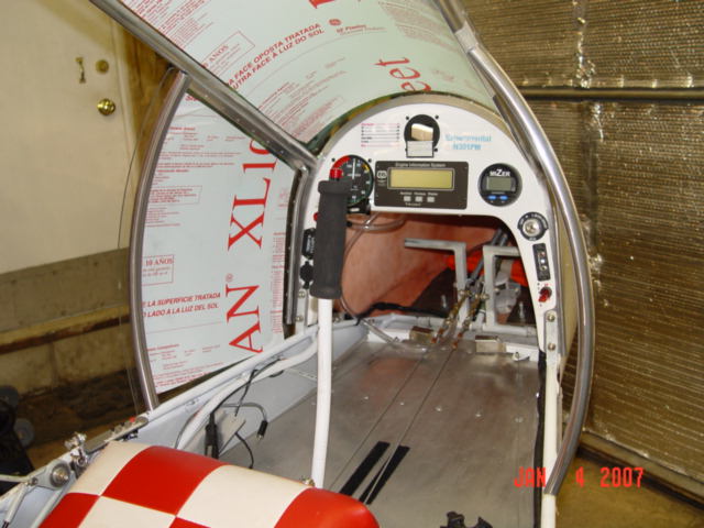

 Filesize:  60.09 KB
 Viewed:  440 Time(s)
 Filesize:  60.78 KB
 Viewed:  445 Time(s)
 Filesize:  60.16 KB
 Viewed:  470 Time(s)

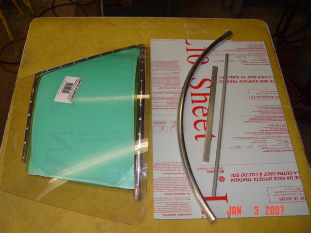

planecrazzzy
PostPosted: Sat Jan 06, 2007 12:25 pm    Post subject: Re: Full enclosure Reply with quote
Hey guys,
The first stage is done....besides matching it to the Gap seal.
Updates are at:
http://wingsforum.com/viewtopic.php?p=5041#5041
Hey Big Lar , if'n yer reed'n this , my last e-mail to ya , Bounced...
To the guys that have written "off list" thanks for all the compliments...
I know it inspired some of you to do the same... Good Luck !!!
I only gained a couple of pounds over the old style ( so far )
But I've heard from John H. that Drag is less with full inclosure ...
So I've probly gained a little already....
Gotta Fly...
Mike & "Jaz" in MN

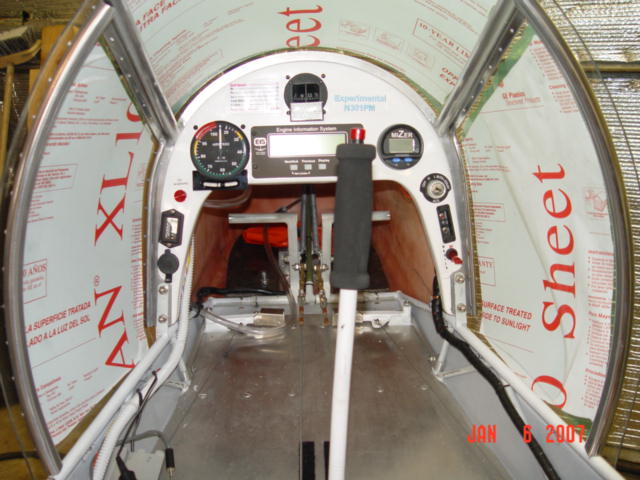

 Filesize:  59.45 KB
 Viewed:  425 Time(s)
 Filesize:  61.38 KB
 Viewed:  472 Time(s)
