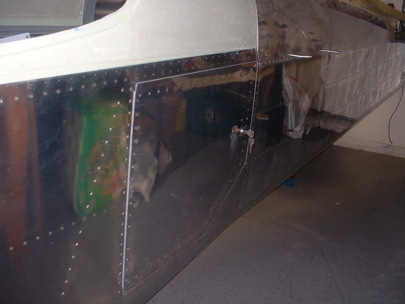

Chris,
I have worked on the door all the way up to riviting it. I have crimped the
inner flanges of the door frame in several areas because the upper and lower
skin edge was slightly bowed out in the middle. Now I believe I have crimped
the flanges about as much as I would want to and the only thing still out of
alignment is the middle of the top frame, which leaves the skin of the door
in that area about 1/8" proud. The corners are all in alignment with the
fuselage, everything looks good except this one bowed out spot. I certainly
can build up the fuselage at the intersection of the cabin top and the metal
fuse skin, but this will not be the true shape that the fuselage should
ideally have.
Any more suggestions would be welcomed, before I get the rivets out.
Not that this will help my situation, but I have also thought about placing
a fiberglass/kevlar super thin sheet which could laminate over the entire
door to seal off the gap on the top/bottom and back. The hinge area will
not allow coverage in that area. My mod would give better aerodynamics than
the 3/32 to 1/8 gap around the perimeter(That is provided I can sinch it
down tight to the skin)
JOhn G.

John, I found that the hand seamer was a great tool to 'adjust' the
baggage door to match the contour of the fuse. just small adjustments
seemed to bring everything in line for me.
Deems Davis # 406

Smack it with a hammer!
Just kidding. I haven't been back to that section yet, I just moved on
for awhile while waiting for new door pieces, but it sounds like you've
got it just about as good as you can get it. seriously, some have
reported that a bit of "man-handling" can improve the fit, but I'd be
leery of that, cause you might just put the corners out of alignment
while trying to improve the bow in the middle, or you might put a crease
somewhere where you wish you didn't.
Just a thought in the vein of the pursuit of perfection... someone
posted somewhere that you really don't notice the slight imperfections
when you're blasting along at 170 kts, or when you don't have a
particular section under a microscope (as you do when you're
constructing that area). It's really easy for me to get wound up in
utter perfection, but sometimes, it really is good enough. personally,
I'm not building a show winner. I think a first-time builder like
myself might not have the skills to do so. What I AM trying to do is
build it better than whatever airplane I rent to go buzzing around, and
I think I'm doing that, both from a safety, and from an aesthetic
standpoint. When I'm bummed that something isn't exactly perfect, I
just take extra time doing my preflight of a rental 172, and I start to
feel REALLY good about my building practices, and about the standard
I've set for myself.
cj

Thanks Deems
Sorry, but haven't used that tool for some time, it is the plyer like tool
with the flat plate on each side. Seems like I could only change the angle
of the frame flange with that tool and I think it is the entire piece that
needs to be bent in slightly. Perhaps making some relief cuts in the frame
(At the intersection of the flange and the aluminum which isn't joined to
the skin or to the close out panel )with a dremel disk and then bending the
material between the cuts would cause the flange to pull in.
close out panel
_Flange_____
_
_
cut here and crimp _
-----------> ___________
flange
outside skin
This should pull the outer fange in in the bulged out area. I only need a
four inch area.
JOhn

I was able to physically apply some torque to my door, using just hands,
it didn't take very much and it got pretty close. the remainder I was
able to use the hand seamer, and make small adjustments, no need to cut
anything.

John,
Your door sounds similar to the way mine came out. I slowly worked it with my hands and the fit improved drastically. I haven't put the seal on but without it the fit looks pretty good to me. I am going to wait until I have the canopy on to install the seal and work it a bit more.
Good luck with it.
Niko

Guys,
Massage, bend, caress and shoot for this.....and use the hand seamer....I did all of that and it's N...I...C...E.
When asked by my fellow builder how I did it?? ....Why workmanship my lad...workmanship.
Naaaahh...metal is your friend once you figure out how to work it (think girlfriend/wife) with total respect.

Really give the hand seamer some thought. I had another builder ask me how I made mine fit so well. It was all minor work with a hands seamer. Take your time and don't bend the edges but use the tool to slightly "bow" them, don't close the jaws tightly on the skin but leave them open a bit so the skin can sort of roll and move as you work it, but just do a little at a time. Tape on the jaws help to keep the skin from slipping off.

The problem I am having understanding the use of the seemer is that the
entire door skin is flat, any shape that the skin takes should be a by
product of the frame's shape which the skin is tied to. I really don't want
to touch the skin and bend it at the edges because it will be very obvious
where the break from straightness/flatness occurs. It seems that the slight
bow in the top part of the frame is what needs to be slightly removed,
perhaps with bend between two hands(Easy does it).
I am trying to digest what you are saying, hoping what I am saying is making
sense aswell.
JOhn G.
