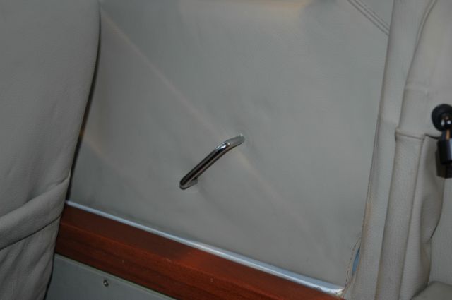

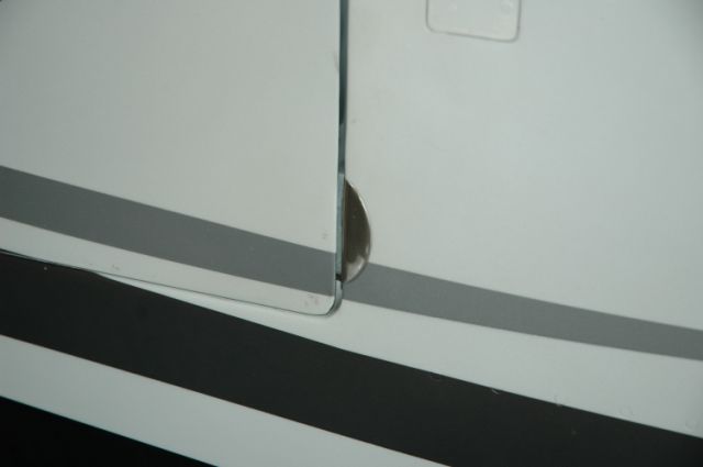

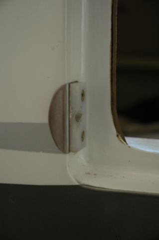

jesse(at)itecusa.org
PostPosted: Tue Dec 19, 2006 9:18 am    Post subject: door latched security system Reply with quote
No aft handle? Paint chipped? Those are things of the past…for some. This aft handle and these stainless plates make a big difference. The latch system is very functional (although ugly), but the problem comes in when you pull on the front part of a fairly flimsy door and the aft pin misses. Having the aft handle makes a HUGE difference in getting the door closed. Also, the strike plates also help if the door pins are part of the way out with the door open and the door falls/closes (am I the only one that has had problems with some of the shocks being too weak to hold the doors?).

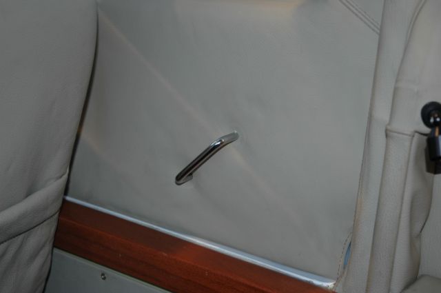

PostPosted: Tue Dec 19, 2006 2:40 pm    Post subject: door latched security system Reply with quote
And adding some weight to the doors would render the shocks useless as
designed (they are barely strong enough as it is). The door, when closed
properly, is as strong as it needs to be. The strength, IMHO, proves to be
lacking a little when trying to close the door by just holding on to the
front handle. Adding the rear handle (just a place to grab, not anything
fancy) really helps with that. To do this, we just drilled 2 3/4" holes in
the inside of the shell where we wanted the handle, filled the area with
flocks, then drilled the holes and put in countersunk screws from the
outside. The handle is a cupboard handle from Lowe's, I think. It works
well, looks good (IMHO) and is very easy. The only downside I see is the
two screw heads showing on the outside, but you already have two at the door
handle, and about 1,500 on the wing root fairings, so what's two more?
Just my thoughts, no engineering or technical knowledge used.
