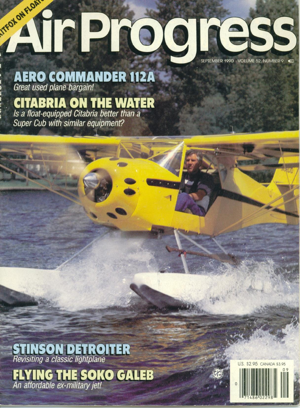

Glenn,
You can definitely put a model 2 on floats, but to do so one needed to add brackets to the lower longerons forward of the current landing gear brackets. I would suggest contacting Kitfox to see if they still sell the add on brackets. That would be easier than trying to make your own.
Here's a picture of Dan Denneys N89DD Model 2 on floats. It shows all four brackets that were available, but you really only need two if you analyze the picture.

Paul ,
I looked at Glenn's picture of his KF 2 on Barnstormers and you can see the rear float attach fitting as it part of the lower wing strut attach fitting that is welded to the longeron. I agree that John Mc Bean would have the front brackets as well. Just cut the fabric and weld them on. Patch up fabric. I would ask John about the cross over tube on the model 2 at read leg attach to see is there was ever a upgrade or stiffner for that area as the KF 2 had a lower gross weight.

Hey Paul, do you have the article that goes with that cover? If so could you scan it and send me a copy?

Just sent it to your personal e-mail Marco. The article however is more about flying the Kitfox on the new aerocet floats (at that time) than it is about the airplane. But it documents the history of Kitfox and Aerocet quite well. Unfortunately Aerocet no longer makes small floats.
