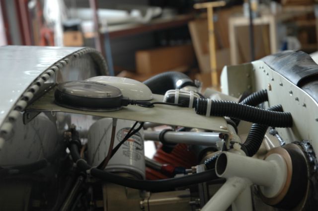

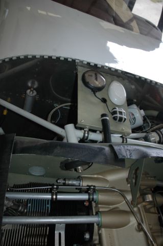

Jim and others,
I am also planning on putting a Garmin GPS into a panel dock. I was
wondering on where you were going to put/mount the antenna? With the
freedom we experimental builders have it sure would make sense to
somehow mount the antenna under the cowl or canopy and not just have it
sitting on the glare shield.
Larry

PostPosted: Thu Dec 14, 2006 3:11 pm    Post subject: Garmin 496 -Antenna Reply with quote
Here's my hidden mount on N416EC. I don't think there has ever been a
problem with reception in 92 hours on the Hobbs.
Do not archive.
Jesse Saint

PostPosted: Fri Dec 15, 2006 7:16 am    Post subject: Garmin 496 -Antenna Reply with quote
I agree; having used the Loran C system, the Garmin 90, Garmin 150, Garmin
pilot III and the Garmin 295, I found that the only time I lost a fiz was
when the antenna was shielded and/or when the GPS satelittes were outputing
lower power. I used to be unable to get a lock inside a wood frame house but
now the power output is sufficent to get a lock in my living room. Another
concern of the FAA I am sure is whether there is sufficent computing power
in the handheld to process the incoming data and update the moving map at a
display rate which is adequate for the speed of the aircraft (had the 295
lockup while using the WAAS sfotware that was available). Most of the TSOed
units will handle speeds of 900+ kts. It would probably be helpful if a
laymens guide to the GPS theory was provided. Another concern would be the
testing and update controls on the software. Do not archive.
Tim(at)MyRV10.com
