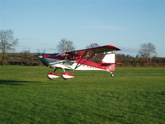

Just to let everyone know I finally flew my Mk 7 on Saturday 9th December after 3 1/2 years construction.
Here are some of the details.
100hp Rotax engine
VP 50 in flight variable pitch propeller
830 lbs empty
Take off run about 200 Yards
Rate of climb 1 up 1/3rd fuel 1200 fpm
Rate of climb 2 up 1/2 fuel 900 fpm
Cruise 60 to 70% power 90 knots (4800 rpm at 26 inches manifold)
Max straight and level 102 knots
3 flights total 2 hours
No adjustments needed
Elevator trim very powerful almost no rudder required at any cruise speed.
Much better than I hoped and a lot different to the Mk3 I had previously.

David, congratulations on your first flight! You built a beautiful aircraft. Thanks for sharing it with us

There is much more inertia with the Mk7 due to the increased weight this makes it more stable. The simplified mixer for the flaperons together with the differential movement results in less rudder input than on the Mk3 and a lot more feel.
My Mk3 had a 582 so the increase in power with the 912S is very noticeable with a significant increase in cruise speed and climb rate.
There are lots of small changes that have added to the comfort. Good heater, no drafts from the doors, somewhere to put the coat and bags, a bit more width in the cockpit all in all quite a different aircraft.
In the UK there is only one other Mk7 flying with two more being built, most of the Kitfox fleet of about 50 aircraft are Mk2 and 3 versions with a handful of Mk1 and 4 and just one Mk5.

Best of luck with your Mk 7 David,
Incidently is it the same demensions as the MK 3 with the wings folded.
John.
david.steade(at)btinterne
PostPosted: Tue Dec 19, 2006 9:06 am    Post subject: First Flight G-CDXY Reply with quote
John
No, its about 18 inches longer and 3 inches wider.
David Steade
