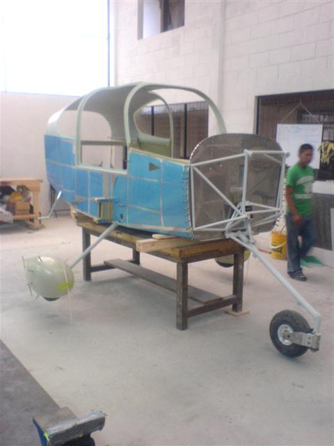

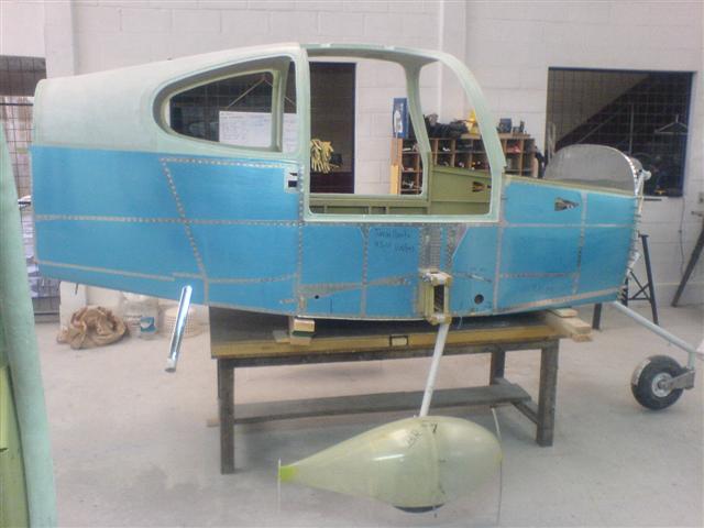

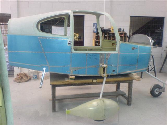

IMHO the attached pictures show an ideal time/place/way to install the
fairings. Any time after this could work also, but it is nice to get them
out of the way early.
Do not archive.
