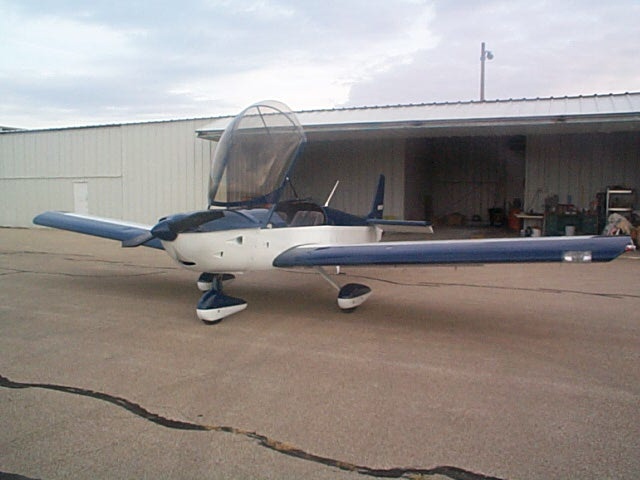

PostPosted: Wed Dec 06, 2006 6:26 am    Post subject: Wing walk tread strip Reply with quote
Larry- I just installed wing walk a week ago. I used Acft Spruce P/N
09-28210. It is self adhesive and is no problem installing. In fact if
you trim the corners to slightly round it won't peel up. when I decided
to paint the plane, I decided to take up the wing walk before painting and
then install new over the paint. It took me and a friend over two hours to
get the adhesive off after peeling off the wing walk. I masked off the
other wing and painted around it. It really has no grit on it to come off.
I think you'll be happy with it.
Al Young
N601AY

PostPosted: Thu Dec 07, 2006 6:19 am    Post subject: Wing walk tread strip Reply with quote
Bill- thanks much. I had forgotten that I had asked you. I wanted to compair yours to mine. I've got a problem with my canopy fit that I cannot figure out. also, when I re-installed the wings, suddenly my flaps wouldn't completely retract. I haven't had time to get into either problem very deep as my wife is requiring my full attention. I will get over to the hanger tomorrow and compair. Thanks again Bill. Regards, Al
PS- I've attached a pic of the new paint job.
