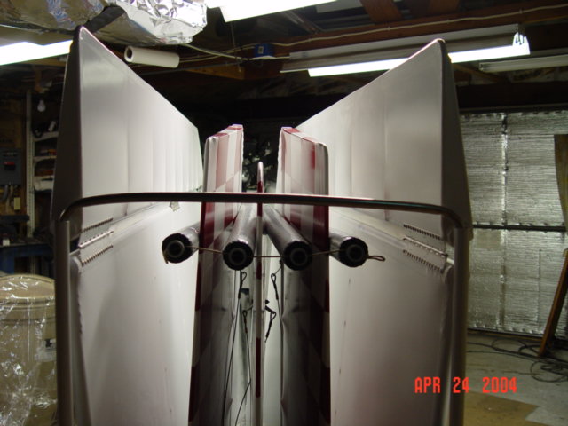

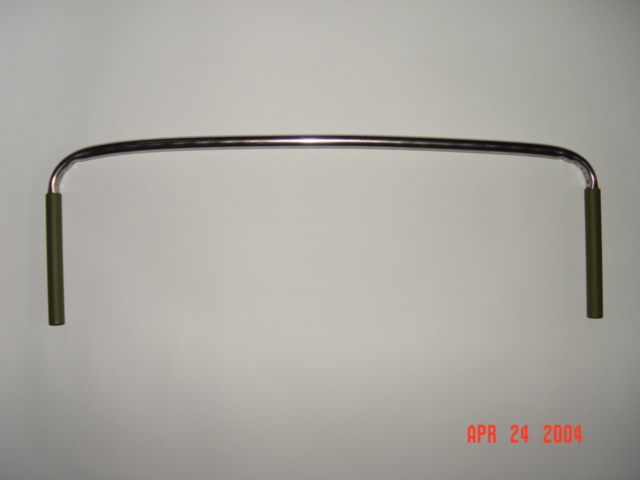

I built my Firestar II aileron hinge area stock.....
But when I folded it up like the plans say , it was just too tight and if you trailer it like that , your gonna get some BAD hanger rash....
So instead , I made a simple bracket to slip into the aileron counter balance tubes , and it holds the ailerons straight up , no rubbing...
Also, I put a bungie cord between it and the tailwheel to keep it secure.
Here's a picture or two...
Gotta Fly...
