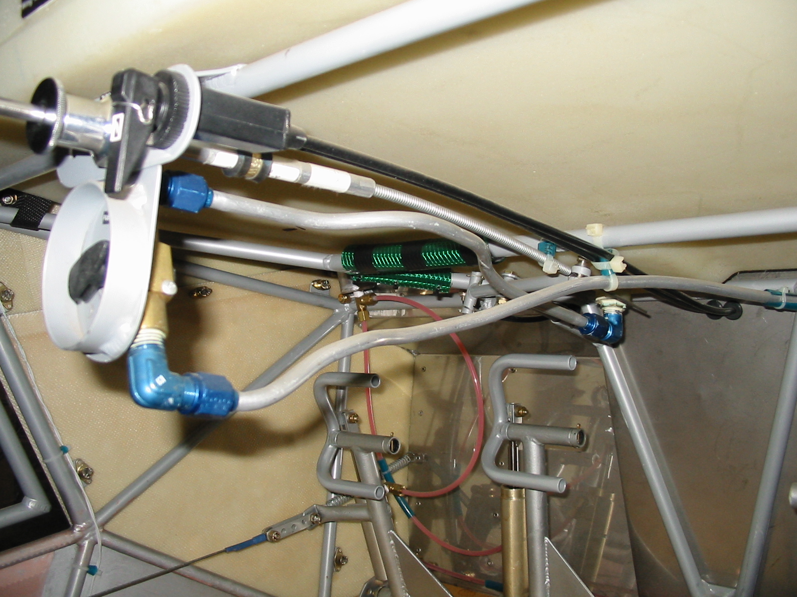

I have a nose tank (panel tank) in a Classic 4. There is no header tank behind the seat. The fuel system is built by the book. Fuel line runs from the outlet at the foreward bottom center of the tank back to the on/off valve at the bottom of the panel, then foreward through the firewall. The gascolator is on the lower right of the firewall.
There is a low spot in the fuel line at the on/off valve with the tail on the ground and a low spot in the line at the tank outlet when the plane is level. I worry about water collecting in the low spots. Has anyone figured out a way to eliminate these low spots in a fuel system like this? Picture attached.

Hi Tom,
Looks like you have a early IV-1200 instead of the Classic as the
Classic and late 1200s had the behind the seat tank.
Anyway I would advise you to reroute the fuel line so that is
gradually slopes to the gascolator and does not have a low spot.
Humps in the fuel line are problematic for causing flow stoppage due
to bubbles in the line. The new routing will probably require new
tubing from the valve to the gacolator. Place the plane in a
horizontal position the use a level to see how to route the new line
to make sure it slopes down hill from the valve.
Regards, Paul

Thanks Paul. Yes I agree the line needs to slope down hill all the way to the gascolator. I can't seem to figure out how to do that with the parts I have. It is a Classic 4 but I think Skystar cleaned out all the miselaneous parts they had laying around left over from the XL model when they filled the crate it came in.

My Classic 4 did not come with a header tank for behind the seat. I wish it would have, then I would not need the gascolator. I purchased the gascolator as an option to install in the low point of the nose tank fuel system.
For what its worth, the wing tanks feed the nose tank instead of a header tank. It looks like I may have purchased my kit just before you did. I should have waited then maybe I would have received the good header tank system.
The problem I have run into is there is no way to plumb the fuel lines into the shutoff valve where it is designed to go and still have a continuous down hill flow.

Why not do away with the supplied shutoff valve and install a valve(s)
where you want it/them, taking into consideration the downhill flow
recommendations.

Don, the fuel valve I have is not the one Service Bulletin #42 addresses about leaking. The fuel line is 5/16ths (OD) aluminum. However, I do remember the flap about the valve on the kitfox List way back when. I never could determine what the part number was for the valve they were talking about.
Lynn, I have considered moving the valve but I cannot find a better spot (with a down hill slope all the way from the tank to the gascolator) for it.
Lowell, is your 4 a classic or model 4 1200. My theory is: My Classic 4 was one of the first Classic 4's and was caught in a transition period of phasing into the behind the seat header tank. I got stuck with the panel tank.
I have done some checking with a level today. With the tail on the ground the fuel valve is level with the tank outlet. With the plane level the fuel valve is five inches above the tank outlet and the bottom two gallons in the nose tank are below the fuel valve level.
I wrote in my builder's log during my fuel flow tests the nose tank drained completely with the plane in a nose high attitude. I guess I better do another flow test with the plane level to find out if those bottom two gallons are useable.
