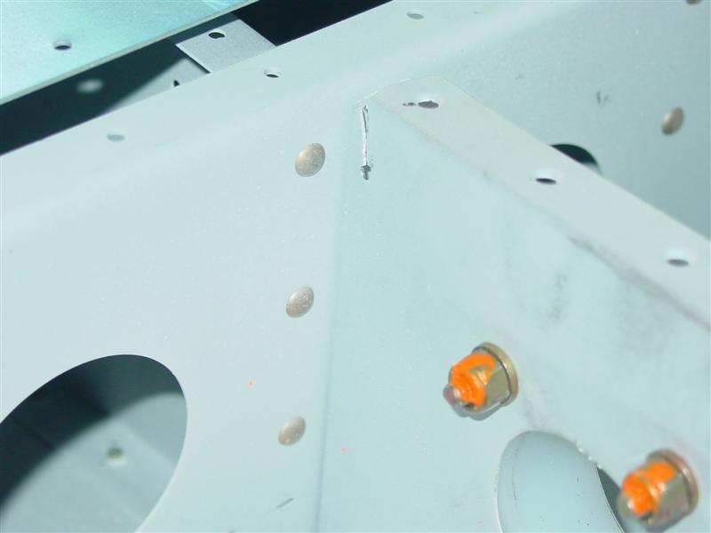

While installing one of the side-steps, I got a little too aggressive and
managed to produce a small tear from the upper relief downward about 5/8 of
an inch on the baggage rib. I drilled a stop, but wonder if I need to do
something more.
Any advice on this one? Picture is attached.
Thanks once again.

I'd check with Van's. It wouldn't hurt to put in a doubler, and would
probably be best to bend a piece of aluminum at least that thickness and
rivet it to the broken piece and onto the piece that it rivets to, carrying
the load where the broken piece will be weaker. Van's will probably say to
either just file out the crack down to the drilled hole and possibly add a
small doubler, but I would certainly at least drop them the same e-mail that
you sent to the list.

Thanks to all that offered advice on the small tear I have on a rib in the baggage area. I contacted Van’s and got the following response:
Sean, found your email.
No problem leaving it as is. Plenty of structure around it so it should be just fine. scott at van's
I will still install a patch for peace of mind. Be careful if you haven’t installed the side steps yet. Until the floors are installed, these ribs are very flexible.
