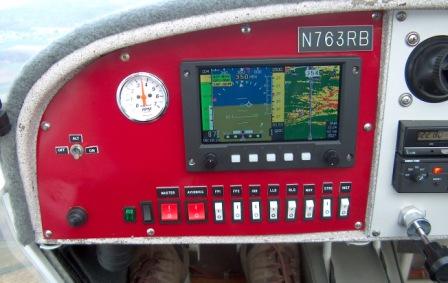

I installed an Horizon Sport HZ EFIS and don't miss the ASI at all. The only need you would have for one is if you plan to fly IMC.
Ben
