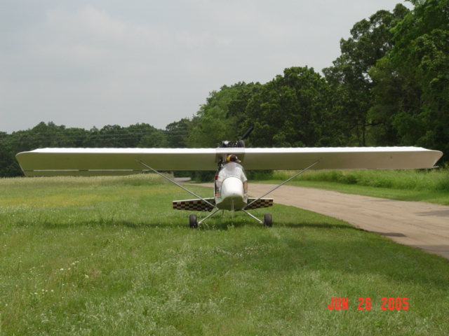

PostPosted: Sun Nov 19, 2006 3:21 pm    Post subject: Re: FSII Dihedral Reply with quote
Hi Dave,
They say that there's No Dihedral in the wing....But in the builders manual it sez how to go about setting the wings and measuring the lift strut length....and it sez you'll get an inch or so of Dihedral....
"I" snuck just a little more....and I've seen others that took "ALOT" more.
My next plane ( Tailwind ) has no dihedral either.... I wonder if I'll sneak a little in there.... I don't know yet....
Gotta Fly...
Mike & "Jaz" in MN
Although from this picture I can't really see the dihedral that I added
 Filesize:  60.64 KB
 Viewed:  668 Time(s)
