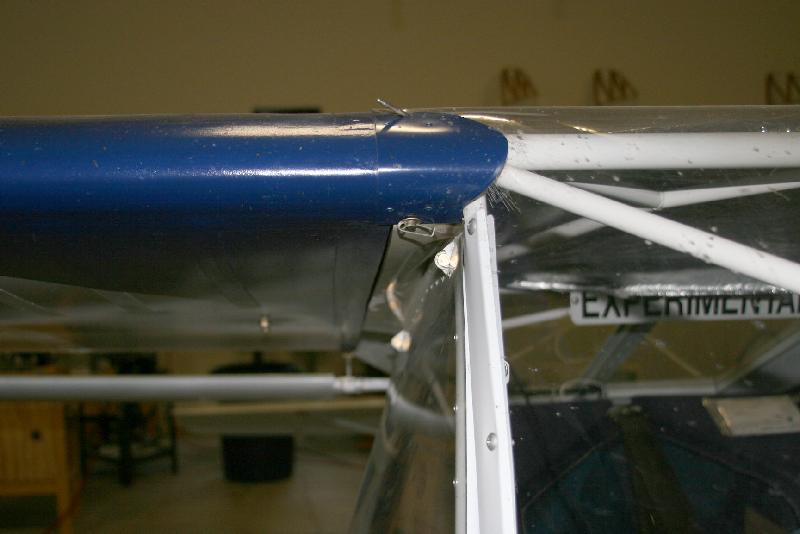

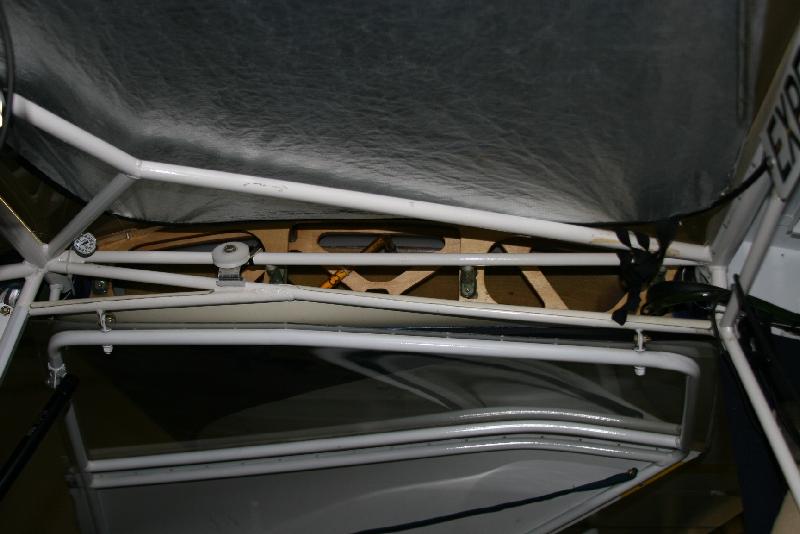

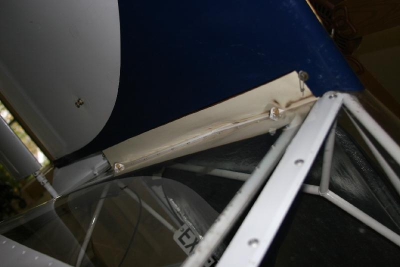

PostPosted: Thu Nov 16, 2006 8:20 am    Post subject: Model IV Buttrib-fuselage seal Reply with quote
Dan, I used the Merle Williams seals and like them. I didn't cover the
ribs but sanded and varnished them. In most lighting conditions, I can see
the fuel level through the tank wall.
Attached are three photos. I found this area tough to photograph to get a
real clear indication of what they really look like. If you want another
angle, drop a note.
Lowell
