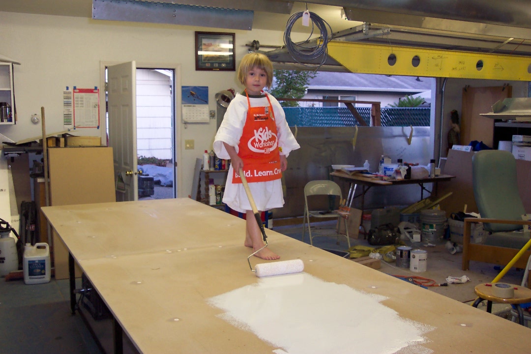

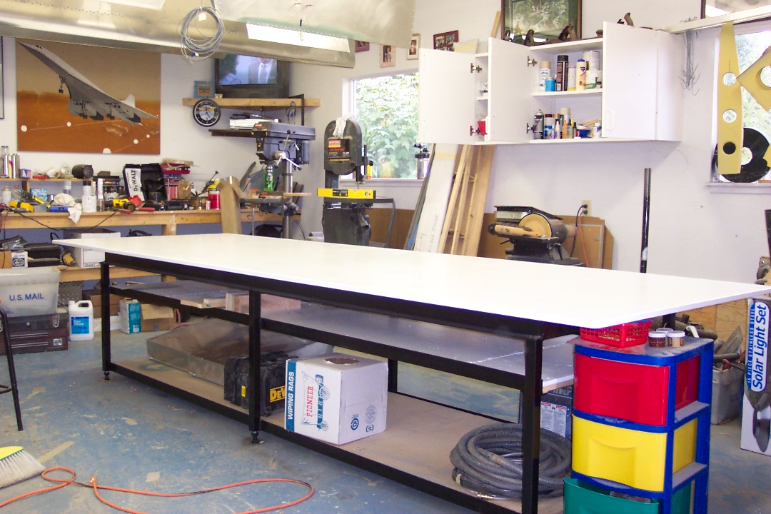

Matt,
My bench is 3' X10'. The top is made out of 4" channel iron. It has 6 legs.
I put 2 levels of angle iron below the top. Welded nuts on the bottom of the
legs for adjustment. So, I actually have a 4 X 10 top plus the lower shelves
for storage and tools and stuff. It's probably overkill, but it doesn't move
and it is perfectly level all around. It also weighs about a ton, but it
doesn't budge. I suppose you could put casters on and level it whenever you
move it. Hope the pictures aren't to big.
Dave in Salem

pacificpainting(at)comcas Guest
Posted: Tue Nov 14, 2006 6:24 am Post subject: Workbench - 10' & Wheels ?? |
I used MDF for my top also. Just painted with a couple coats of semi gloss latex I found in one of my trucks. I don't think it matters what you use. You don't even have to paint. It makes it easier to lay out lines if you want and also to find little things you might have dropped on it.
Posted: Tue Nov 14, 2006 6:38 am Post subject: Workbench - 10' & Wheels ?? |
Actually, my table top is 4X12. 14 ft long would be nice, but I don't have
the room. I like your idea about the trailer jacks. I might have to do that
if I need to move it. It takes 4 people to do that with the top on and all
the steel in it. That way it could be moved without unloading all the stuff
on it first.

************************************* Keith Ashcraft 4 3 2004-01-06T20:01:00Z 2004-01-06T20:29:00Z 1 34 198 ITT Advanced Engineering & Sciences 1 1 243 9.3821 <![endif]--> Print 150 <![endif]--> <![endif]--> <![endif]-->
Keith Ashcraft
ITT Industries
5009 Centennial Blvd.
Colorado Springs, CO
80919
(719) 599-1787 -- work
(719) 332-4364 -- cell
keith.ashcraft(at)itt.com (keith.ashcraft(at)itt.com)
[quote]************************************ This e-mail and any files transmitted with it are proprietary and intended solely for the use of the individual or entity to whom they are addressed. If you have received this e-mail in error please notify the sender. Please note that any views or opinions presented in this e-mail are solely those of the author and do not necessarily represent those of ITT, Inc. The recipient should check this e-mail and any attachments for the presence of viruses. ITT accepts no liability for any damage caused by any virus transmitted by this e-mail. ************************************ [quote][b]
Posted: Wed Nov 15, 2006 3:49 pm Post subject: Workbench - 10' & Wheels ?? |
Keith,
Looks like you could build half a plane in the time it takes just to get your shop ready. Lots of work. I would probably die of altitude sickness at your house. It's about 200' MSL around here.
Dave in Salem
Willamette Valley flat lands.
