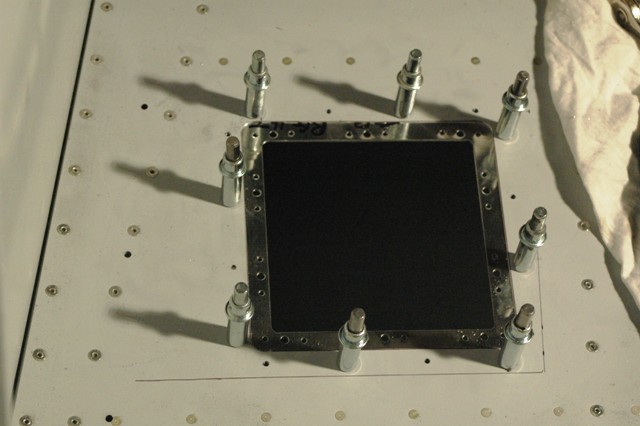

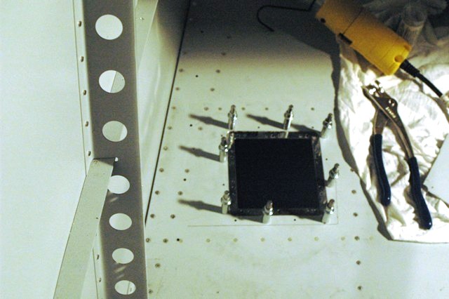

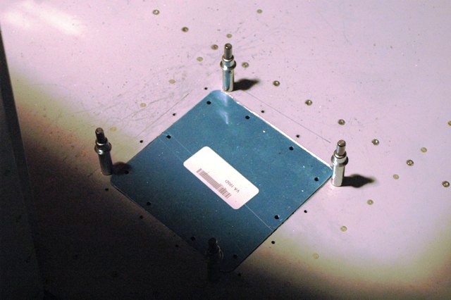

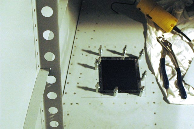

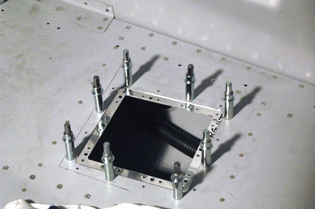

Attached are pictures of the access panels I created in the baggage area using the standard stall warning cutout parts.  I believe that the doubler Vans provides is too thin so I used two doublers per each cutout. Typically the doubler should be at least 1.5 times the thickess of the parent material. In this case each doubler is the same thickness as the floor skin. The cutouts came out well and I can also reach the step bolts with them in case the steps need to be come out at a future date. So far it took 5 hrs and I have about another 1 to 2 hours of deburring, priming and riveting the parts to finish it.

I also did something similar using the stall horn access panel I had laying around as a template (put in an AoA instead of stall horn). You can see some pic’s here:
http://www.mykitlog.com/users/display_log.php?user=msausen&project=22&category=613&log=15009&row=33

Looks nice. Did you put in two, one near each outboard side?
