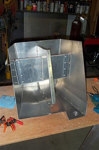

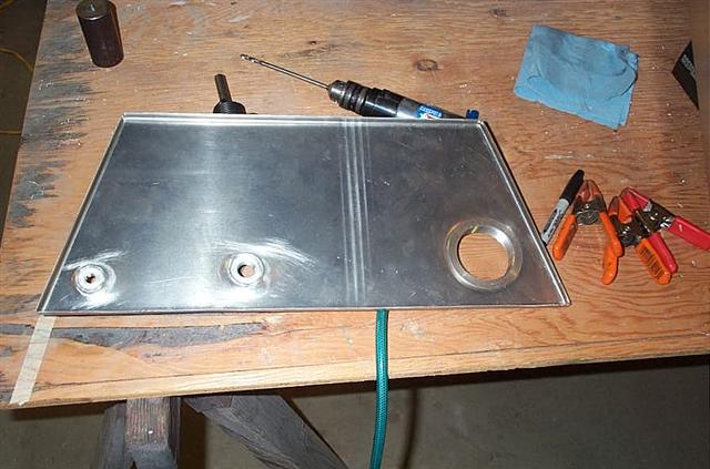

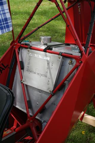

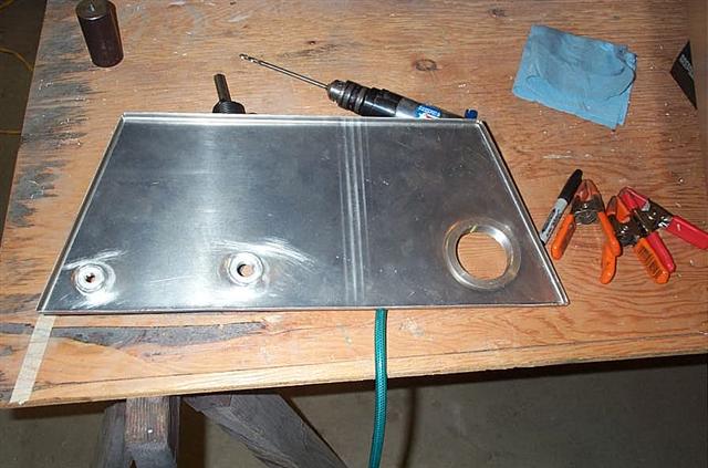

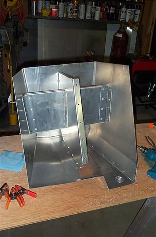

With the posts lately about increased fuel and aluminum tanks I thought I'd add my two cents worth.
A priority from the start of building my Firestar was to provide for more and reliable fuel. I'm not much of a fan of plastic jugs either, although their simplicity is a big advantage, I have to admit. Safety in a crash and keeping fuel weight forward as far as possible were other considerations. I ended up making the "bulkhead" at the end of the fuse tube removable and mocking up a cardboard tank that held a little over 14 gallons that sat on the tube and fit the taper inside the cage.
The tank is cross baffled with a quick drain at the back of the sump to drain water when parked and the finger strainer at the front which is lowest when flying. If I was doing it again (and I might) I would shape the tank sump somewhat differently and make the fuel inlet at the back to get the last drops while climbing. I just never thought about it until the tank was finished. A drawback of working alone I guess. As it is, with a gallon in the tank it would take a fairly steep climb to unport the inlet.
A word about welded tanks and sloshing. I was pretty proud of my tig welding and thought I didn't need no "steenking" sloshing. Wrong! Long (ugly) story short, when I put fuel (mix) in the tank to start the engine break-in I started noticing "oily" spots on the tank. The gas was seeping out, evaporating, and leaving the oil in about 3 places. We all know that a drop of oil spreads out and looks like a gallon, well there were a lot of drops. So I swallowed my pride, rinsed the tank, etched it with Alumi-prep and sloshed it 3 times. No seeps now. I think if you could get a certified welder from Boeing or space shuttle work to weld the tank up it would probably be great, but for this normal mortal, I'll use the slosh.
If Kolb made a high capacity plastic molded tank to fit our planes, something with the fuel inlet out the bottom, I sure wouldn't have bothered to make one but since they don't I'm pretty happy with this one. Nothing like a little extra gas, unless the plane is on fire. Wink
